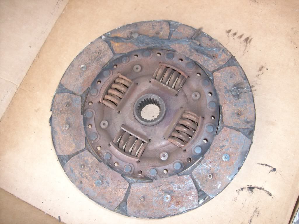

The bell housing looked like a rat made a nest of clutch material, it was that bad. The pilot bearing was pretty much shot too. The fly wheel was a little scored, but I think I can clean it up with some sand paper.

I had to buy a slide hammer to pull out the pilot bearing. I think I bought the only one in the Houghton/Hancock area. The downside to living in small town is that they never have the tool you need in stock. I yanked the bearing out and put the new one in. Cleaned up the fly wheel with some sandpaper and brake cleaner. Put the new clutch in and put the whole thing back together. With the exception of the starter cable not wanting to go on, the assembly was a piece of cake. Here are some pics of the old clutch driven disk

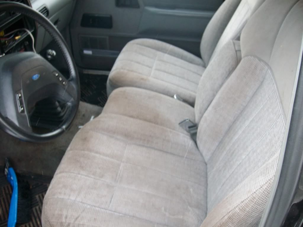

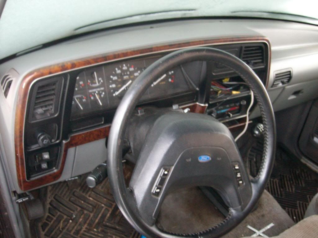

Here are some pics of the interior. It was cleaner before I fixed the clutch. I stupidly decide to climb up in the cab when I still had by oil cover clothing on.

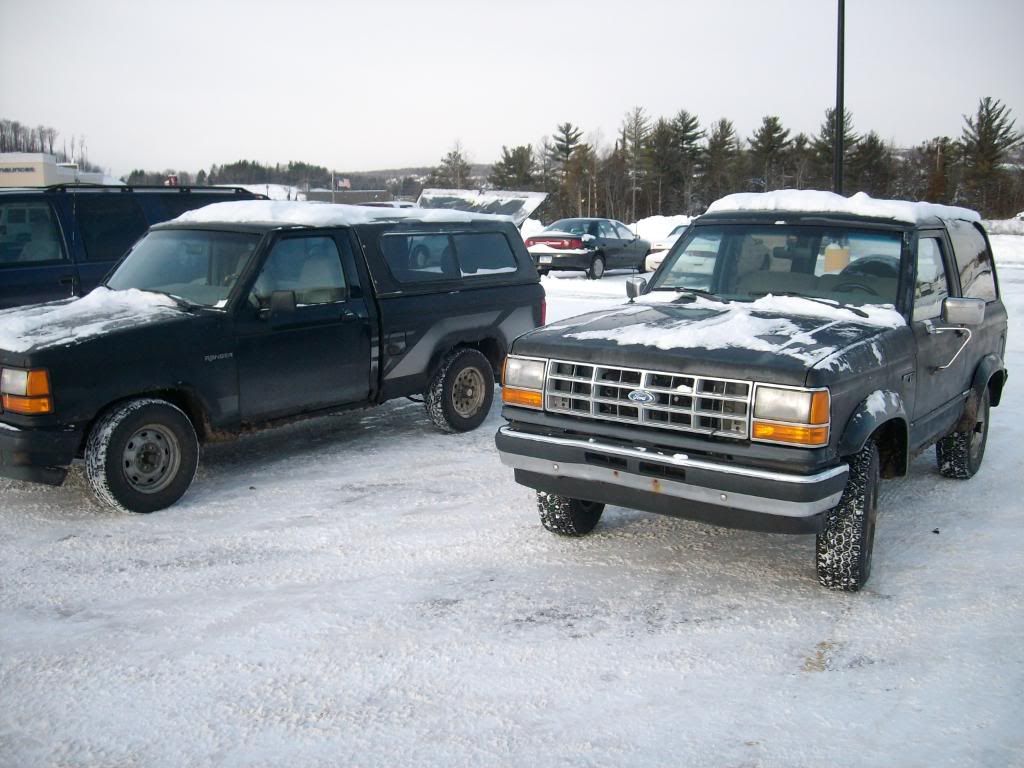

And here is Betsy and Bobby in the local Wal-mart parking lot. Don't they look so cute together.

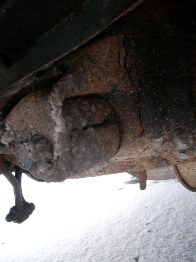

THE LEAF SPRINGS ARE IN! last week I put in the driver's side and today I put in the passenger side. It was interesting driving around with one good leaf spring and one bad. I would get lots of body roll turning left, and barely any going right.
The driver's side was a pain. Jacked up the truck. Pulled the tire. With some grunts I was able to get the u-bolts off. Then I tried to remove front spring bolt. I couldn't remove it with my wrench, or with a breaker bar, so got the longest pipe I could find and tried to get it off. I ended up cracking my socket :bawling:. To avenge my poor socket, I got a new angle grinder and cut off wheels and cut the bolts off. turns out the space behind the bracket was completely filled with dirt. [insert pic here] it completely rusted the nut making it pretty much impossible to come off[insert pic]. With the help of the angle grinder I got the old leaf out and wrestle the new leaf in. Seven hours later I am driving home to warm up because I had nearly given my self frost bite working on the truck.
