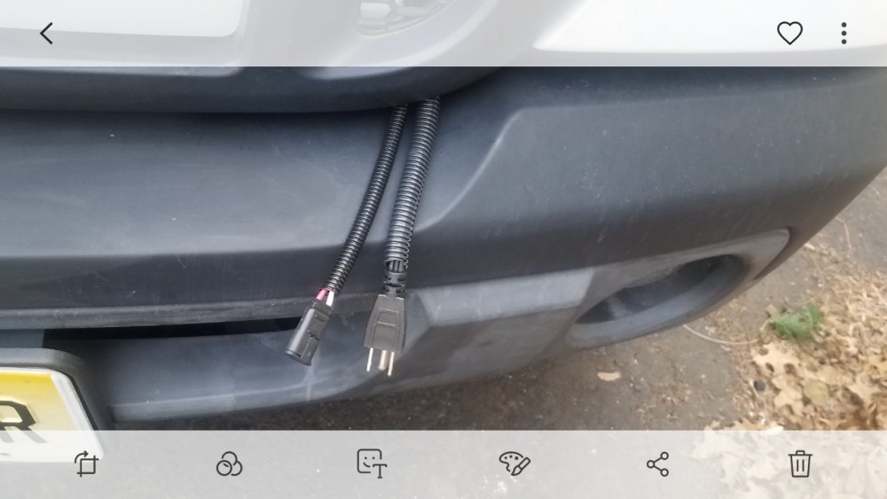

Hooked it up to the battery. I fused it. What fuse should i use for a 2 amp charger? Its one of them smart fancy maintainers but i still want the harness fused. Im thinking 5 amp?

I think the purpose here was to have a quick easy way to connect a maintainer without opening the hood. Looks like "mission accomplished" to me. I don't see a reason to charge a power bank and then use that to charge the truck. Seems like extra work and time.
Yea why would I charge one thing to charge another thing? :icon_confused: plus the point is to use a long term battery tender not a jump pack. I solved the issue months ago. The extension cable hanging from the grill works perfectly.
