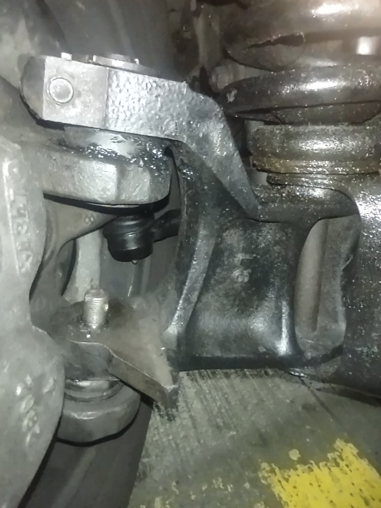

So all the video's I've seen online look very different then the suspension I have. So I'm not really sure how to tackle this job. Main point is I don't have a press or the ability to drop 100 bucks for one so I'm trying to attempt it with what I have on hand e.g; c clamps l, hammers. One thing I noted in thenl video's is everyone ones ball joints were inverted from how mine are .. not sure if that's due to the different construction but I could only assume they are intended to go in 1bway and can't be installed backwards?
So do they press down for removal instead of up?

Upper ball joint is pressed into the axle beam... lower is pressed into the knuckle. Ball joint orientation varies by vehicle, some are up, some are down. 4x4 trucks are opposite of your 4x2.
