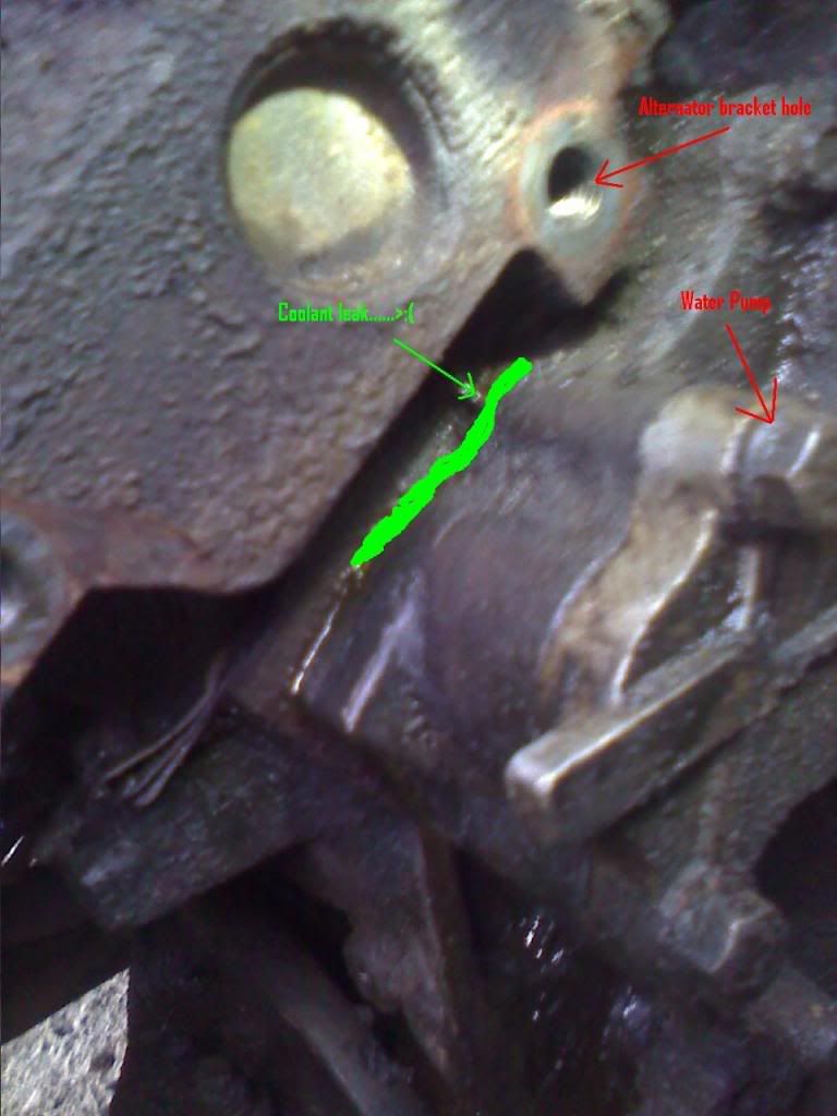

Truck has a bad coolant leak. It's not HUGE, but its slow and constant when the truck is running. Found out at work on thursday when I went outside on my break and found a huge puddle of coolant under my truck. Upon further inspection today, I found where it is, but I don't know what it means....besides a leak. Could it be a cracked head? Blown gasket? I took a picture, sorry for the small text, it was bigger in paint....
From your description and picture it looks as though the leak is comign from where the front cover meets the block. There is a gasket there, and a coolant passage from the block, throught the front cover, to the water pump. Does it leak all the time when it is running or just when the truck is hot and the system has pressure on it?

Oil and coolant are still seperated. Did all the checks for a blown head gasket just to be safe. It leaks when running, and continues after its shut off and still warm. It's at my parents house at the moment. Don't have the time or location to fix it yet.

It looks to me like it may be coming from the core plug just above the leak in the end of the cylinder head. Scratch the plug with a screwdriver or something, and see if it punches thru.
The head gasket could also be leaking to the outside.
Also check the intake manifold where it bolts to the cylinder head at the front. It could be leaking and running down.:)shady
We did check the plug, and it wasn't leaking there, after we pulled off the alternator we could see exactly where it was leaking because the engine was still a little warm and there was still some pressure built, and it was bubbling out, but i'll take a peak at the intake manifold as well. Thanks Shady.
I had the same symptoms and had all the same questions. You need to replace the timing cover gasket. Fordwheelinman is right, there is a coolant passage within the timing cover. It is not a hard job. Gasket kit cost less than $10. It is a pain to get to but well worth the cost savings. This is one of those jobs that the labor cost is 90 percent of the bill. You will need a puller and installer for the vibration damper, and a strap wrench for the fan clutch. Good Luck!

Well guys, you are all really on the ball. After reading some of your replies I second guessed my diagnosis. I jumped the gun. I took a second look and the timing cover is definately leaking coolant, boy am I glad I took the time to double check, it would have really sucked doing a headgasket job for nothing. Thanks for chiming in.

That's a very easy job to tackle. Judging by those pictures the the timing cover looks like it hasn't been off since it rolled of the production line. Give those bolts a good soak down with Parts Blaster before you start pulling it apart. Those bolts can be a bitch to find if you break em'.
