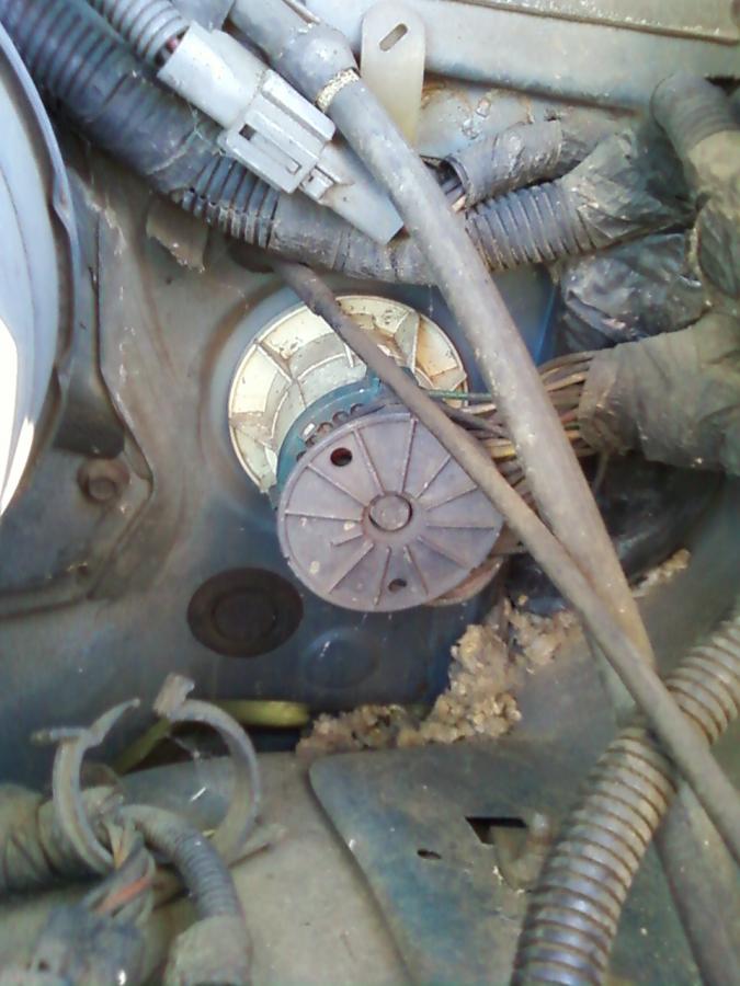

So here is my dilemma. The 89 and up all have the large wiring harness plug connected to the firewall while my 87 has the wiring harness pass through the firewall with a rubber boot around it. Since I dont have a plug and play option here, how difficult will it be to try and connect everything to this plug? There definately is not the same amount of wires. Kind of stuck between a rock and a hard place here since I dont have much options for replacing the original dash pad.
Are the rubber boot style opening and the plug style opening the same? I've always been told they swap over...
SVT
On my 87, the wire passes through the rubber boot in the firewall. Strands of the different wires are taped together or wrapped in flex hose going through the boot.
