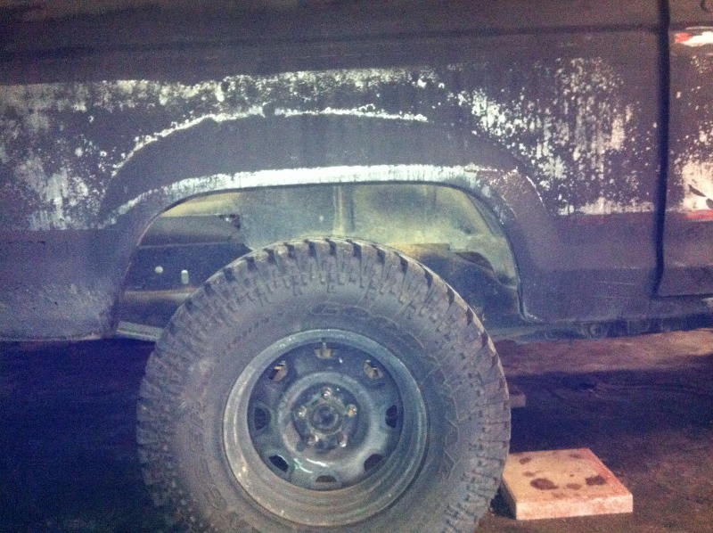

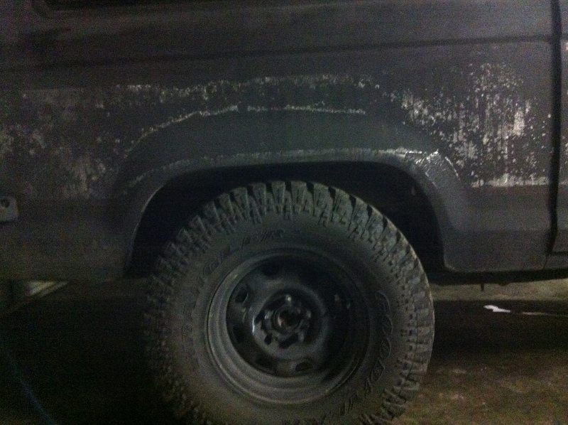

this is mine with add-a-leaf, 2" body lift, and trimed fenders
I would say it gave me over 2" of lift when i first installed them 3 years ago
but nowthey'ed sagged to maybe a little over an inch
Just installed very surprised lifted about 2 to 2 1/2 inches.
