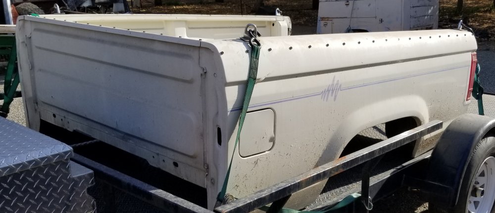

Shran one must first have a life(speaking of myself). Thanks for the heads up. I thought it might be that easy, already have the buckets. Are you changing just the calm shell or the entire assembly? May do that tomorrow night. I got the shortbed for the chop Sunday. Went to the JY today, got an uncut wood grain dash and the correct stereo mount not the hack the PO did on the dash hence the new one. And the side pillar trim(got lta paint match as there were only 2 pre 89s in there. Will probably got back this week end. Need more tools than what I brought today. Found a Dodge D50 or whatever with a cool an straight chrome bumper, thats simikar to the 85 and below stock Ford rear contour bumper so it should match after I make new brackets and install a hitch. Damn sites says my pics are too big to post.
nice looking box. Wish they were that clean up here.
