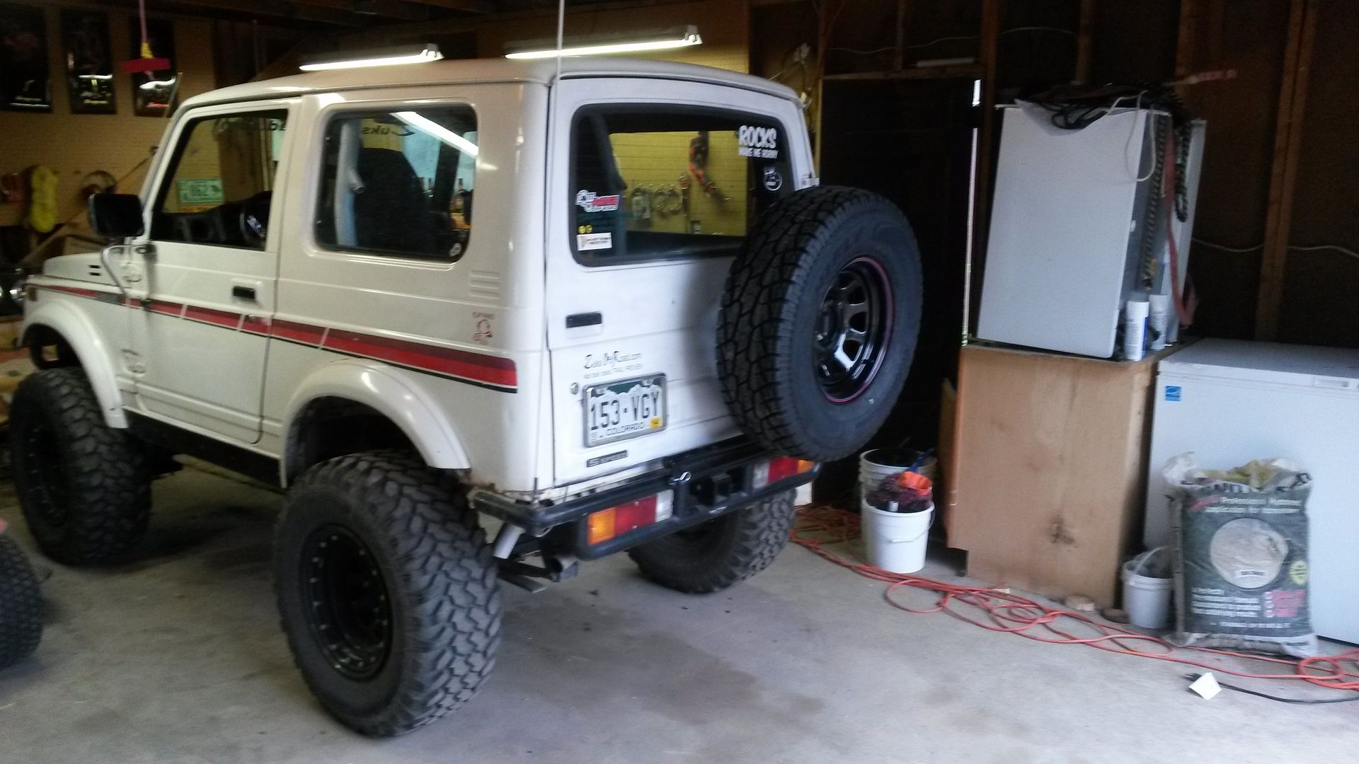

Prep is the main thing (as with any paint job). If you skimp on the prep, the end result will look like crap. I havent used a roller but I did rattle can the back door of my white Samurai (it was a red door). roughed up the surface, cleaned well, then p[ainted it. Its didnt come out a shiney as the rest of the Samurai, but it matches close enough...
I did clear coat it after. It passes, but its not perfect...
