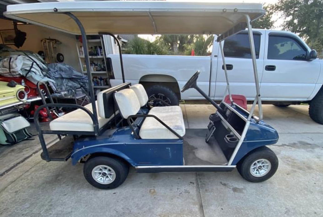

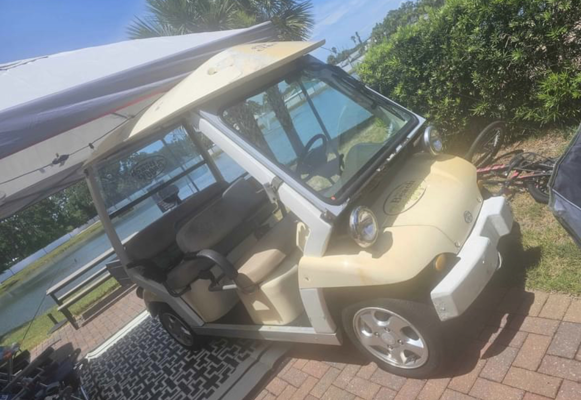

Here’s two I’m half way looking at. There’s a 2006 club car and 2011 CT&T. Near zero info info on either besides they don’t run… not even sugar coating it. The CT&T was clearly a beach rental as its full of marketing, has bald tires, and probably had a hard life. Club car asks 1850 and CT asks 2000. Seems like for either I’d want to only shell out 1000. They probably need a grand in batteries and probably a couple hundred in electronics. Think I’d lean toward the club car for a first time cart. For 3000 I can get one that claims to run fine, but I’d rather know for sure that the batteries are new. Both look great cosmetically. They have discoloration and that spotty mold stuff on the seats, but other than that the pics are promising.
that second one actually looks like a yamaha. i had not heard of ct&t.

the only issue i ever really would be worried about it the frames being rusted. club car used to be the only aluminum framed golf cart so they were the most expensive brand. the ezgos, yamaha, harley/amf carts, and others were steel and the battery support area of the frame would always rust out. i am not sure how close you are to the beach but that is one thing to consider.
the brake pedal bushings will freeze on any brand if you are near corrosive water (irrigation or beach). they are brass and the arm is steel so you get dissimilar metal corrosion from the chemicals in the water getting in there and eating away the grease. its a very easy fix though as you just tap out arm and replace the bushings with more grease.
that ez-go is going to have the electronic controller and smart charger. is it a 36v or a 48v system? if the charger is square, its 36v. if its round, its a 48v system. the other one is probably 36v as that the most common one. back in the day, only club car made a 48v cart.

lots of golf cart companies made long carts for hospitals and transportation places. that second cart looks like its actually made for that kind of stuff and might have a more automotive type suspension set up. for sure, the wheels are larger and probably won't be available to the local tractor supply or walmart, like the golf cart tires are. golf cart tires can be put on with a manual small tire mounting machine that you can get really cheaply. tires are also very cheap for golf cart size wheels.

I have no idea about the CT&T. Just repeating what the ad said. Wikipedia says it's a Korean battery vehicle company. Probably is quite a bit more invloved than a typical golf cart. I'll probably let that one be. I messaged the Club Car ad and will see what he says. Both carts have most assuredly lived a significant portion of their lives just a few blocks from the Gulf. Mostly It'll haul 2 people, but needs to be able to haul 4. A flip down back seat would be exceedingly handy tho.

The club car looks really good so bring a multimeter snd see what the voltage is on the battery set.
Another way to tell 36v versus 48v systems is the batteries. 36v systems have 3 caps for water on each battery and 48v have 4 caps for water. Each battery should have 2.2v per set of plates and you can check each with a hydrometer. Look in the battery caps and see where the water level is. It should be just barely above the tops of the plates if discharged. If they are full and the batteries read dead, the people probably never took care of the batteries and just realized they were empty after they were dead.
