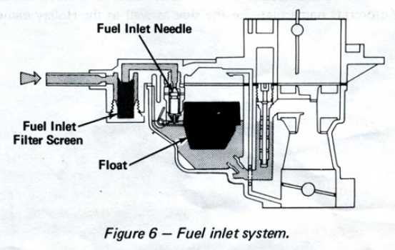

I have never seen a carb that COULD backward drain the fuel out into the tank. All I have ever seen have the needle on the top of the carb and out of the fuel itself, so they cannot drain backward.
I suggest turning the idle mixture screws to a much richer mixture and then adjusting the fast idle screw back down. Most likely you have adjusted your carb into never-never land.

Drop by the house and I will show you one, LOL. It is a Weber 32/36. The Holley 5200 is a licensed clone of that carb.

According to all the natural laws I am familiar with backward draining from the Holly 5200 would be impossible.
The first thing a plumber learns is "shit don't run uphill"!
Here is a picture.
Big Jim

According to all the natural laws I am familiar with backward draining from the Holly 5200 would be impossible.Here is a picture.

I don't understand it either; but, ain't going to shoot a vid to prove it. It isn't worth my time. And the bowl vent isn't plugged either. Just know without a great check valve it does it. :beer:
