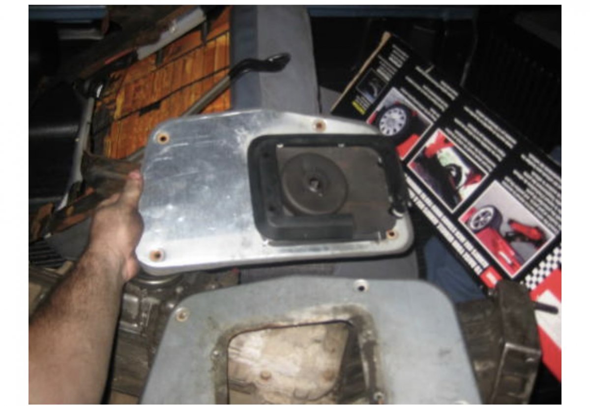

Yeah... getting them out is no big deal, gravity helps a lot.

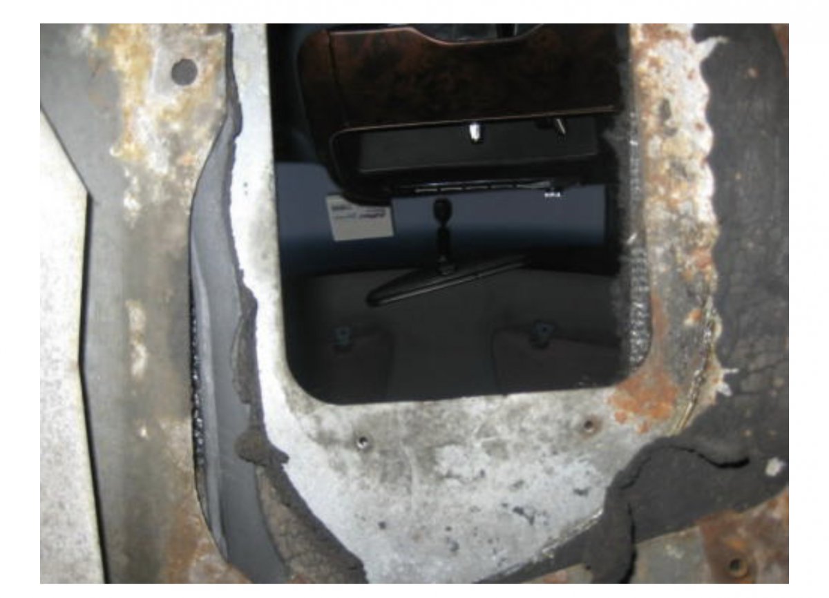

I flatten the pinch weld on first and second gen V6 trucks. It's not really necessary on 95+, definitely not needed ever on 4 cylinders and 3.0 trucks.
If you do decide to flatten your pinch weld, do yourself a favor and cut a few slots in it with a sawzall. Makes it a lot easier to bend it as separate pieces... you'll wear your arms out fast if you try to flatten it all at once.
