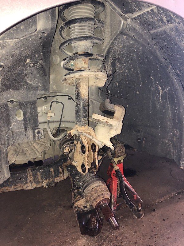

This is the first of the old style bearings ive ever lost. Hell rusty #1 has the originals still in it, i think i mighta packed them once.
The bolt on ones are nice, but i dont mind getting greasy to change a 10 dollar set of bearings over paying 250+ to stay clean.
She does have 200k on it and has never had it changed so it really isn't doing THAT bad.
Still incredibly annoying. And you have to mess with the eccentrics for the alignment to change said bearing.
Unit bearings for my F-150 are around $100, hers was $30 for a Timkin.
I just paid 35 for bearings/seals/races for both sides. High quality chinese crap to :D

But you didn't get to do all this fun stuff + blow the old race off the hub with the torch now did you? :icon_confused:
Nope, cant say that i did. I havent even touched mine yet lol.
