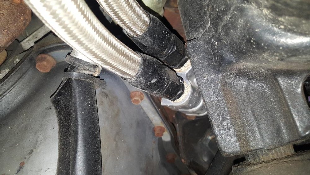

That being said, I'm using the Transdapt unit on my truck but I converted it over to use -6AN fittings and stainless braided hose. Again, cheap insurance.

i hate to buy 1 of the other brands until i here someone actually use it with success.i never used 6AN fittings b4.r they hard to work with?and will l&l clear geabox as well.i know trans dapt does but alot of issues with it.what did it cost to use the 6AN fittings and braided hose?u replaced all the brass fittings with the 6An fittings?have pic on what i looks like?

FYI; JIC fittings fit the same as AN and are a LOT cheaper. Not quite as close tolerance as AN but does just fine.
and thats with the trans dapt kit 1113?do u need special tool to force barbed end into fitting?
into hose i meant
AN fittings aren't barbed and AN hose isn't typically used with barbed fittings. You'd need NPT thread AN fittings that screw in to the oil filter adapter housing, and then the hose and AN fittings that thread on to that. Look on Youtube how to build AN hoses and it will give you a better idea how it all works.
