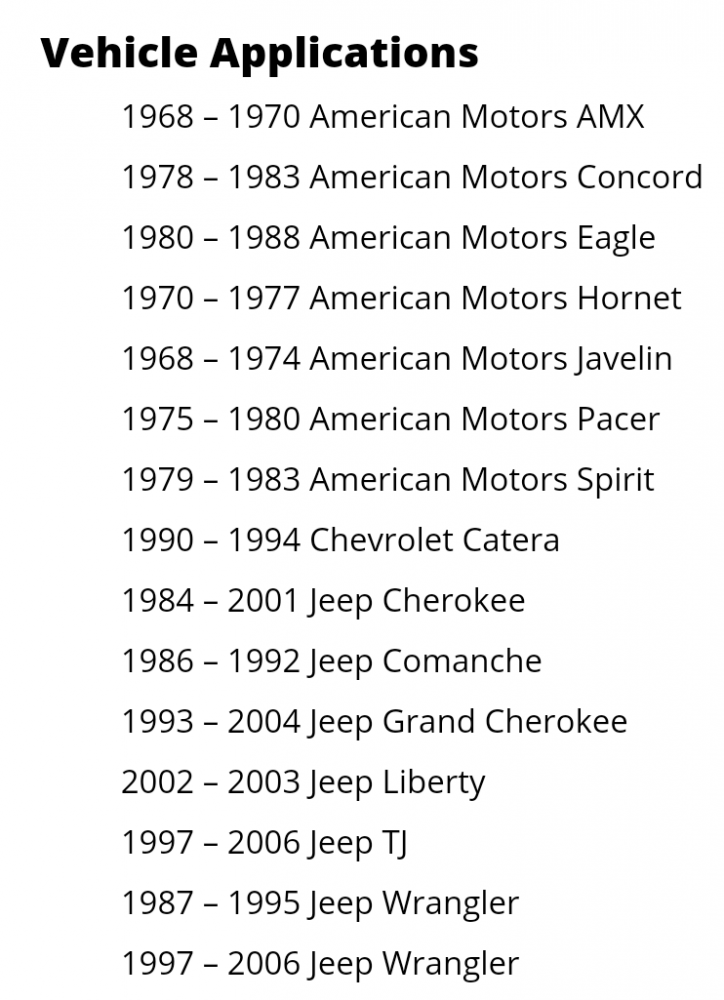

The grip ls is a clutch pack unit, the grip lok is a full locker, and the pro is a mechanical limited slip like the Torsen. The part number for the Pro that may work for the SLA Ranger is GT443527, and the Lok that is officially listed as compatible is LK443527.
The LK shows these applications:
And here's the GT's list:
I honestly don't understand why there's such a discrepancy between the lists of two that in my mind seem like they'd fit the same applications... Full carrier Dana 35 replacement for 27 spline shafts. Anybody else understand?
Standard rotation vs reverse rotation? I believe RBVs are standard rotation with the IFS.

Maybe so. It's odd that about half the entries appear in both lists, and that the part numbers are basically the same minus the LK vs GT descriptor.
