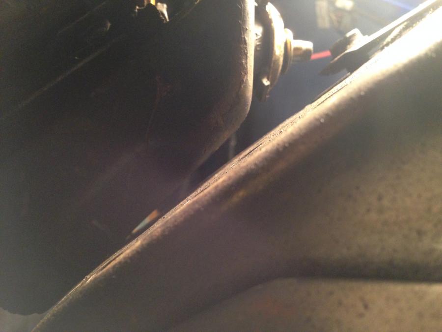

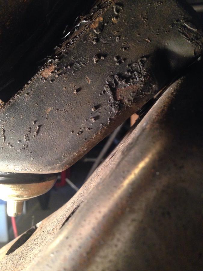

Pictures of advanced adapter motor mount issue
Here are pictures of gaps between mounts and crossmember I am seeing. I haven't set motor in yet, but had dabbed a plate to hold mounts apart recommended distance.
Driver side mount.
