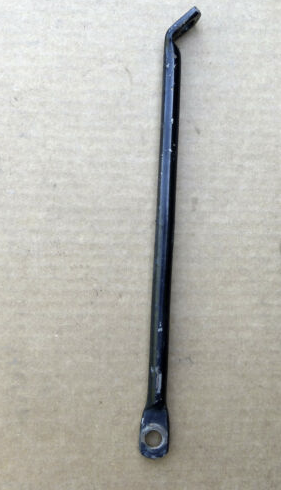

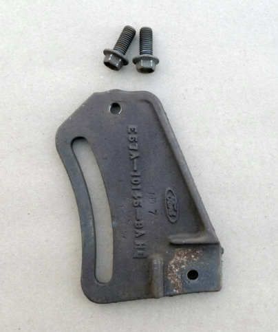

Here's one that may work. It looks like you'll need the alternator one too though
Part number E57A-3F671-EA

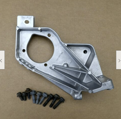

alright so this is what I'm getting:
32991
32992
32993
plus a remanufactured pump+pulley+pump cap, a ps gearbox with pitman arm and the bottom part of steering shaft that connects to my steering column, the two hoses.

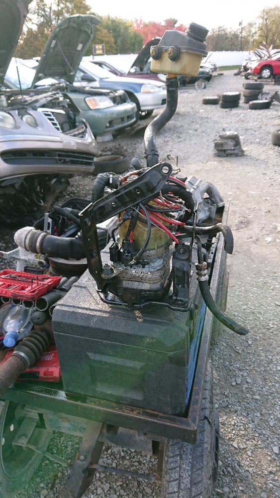

To do the swap, you need to find a volvo donor, or get one of the pumps from eBay. I went into the wild this week to get one, and mostly to take photos for the tech section. Shipped the one in the photos to its new owner. Looks like we're soon to have two EPAS Rangers running around. ??
This is a particular Volvo that can be used as a donor:

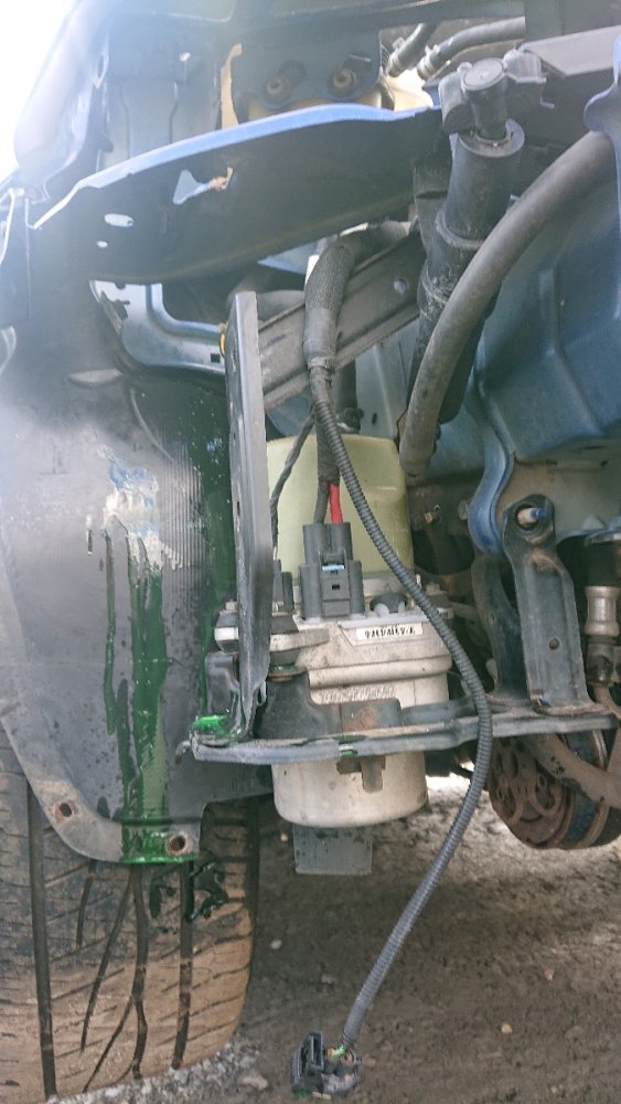

EPAS pump in its original location, passenger side bumper cover. Only parts that have been removed are the bumper cover and foam impact pad. Forgive my sawzall hackery. Wanted to show everything as clearly as possible.

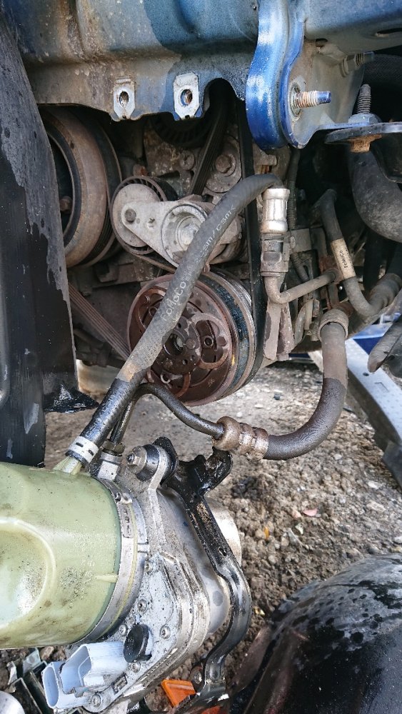

AC components removed:
Make sure to cut the hoses in the rubber sections and keep the metal ends. Critical that you do this. The pump fitting is a metric 16x1.5 flared o ring. Amazon sells an adapter if you cannot get that part. Note the FoMoCo brand stamp on the pump and hoses:
Also critical to take as much of the wiring harness as humanly possible. You'll have two pigtail connectors, one for the pump speed, the other for pump main power. Without these pigtails, you'll be forced to get them from Volvo. Prices range from $25-90.
Mazda 3 also uses a similar pump, as well as the Toyota MR2. The Mazda pump uses an alternator sense wire instead of a power wire. At some point I'm going to snag a Mazda pump to test and see if it's better than the Volvo one. I know almost nothing about the Toyota one, other than they are very expensive.
My favorite thing about the swap is that I still have power steering if the engine is off. Also it removes the parasitic load of the pump from the engine, which is always good.
Only downsides are that they take a bit of power (up to 79 amps) to run at full lock, and they can be a bit sluggish in a parking lot. I have a 3g alternator swap on mine though, so power has never been an issue. The parking lot thing was a tad frustrating at first, but I don't even notice it now. Just turn the wheel.a little slower.
Other thing that's really nice is the amount of road feel they give. Makes the teuck much easier to handle on the highway. I don't get blown around by tractor trailers, and I don't have to correct the wheel when I hit a pot hole; there's enough resistance in the box to keep the wheels pointed.
