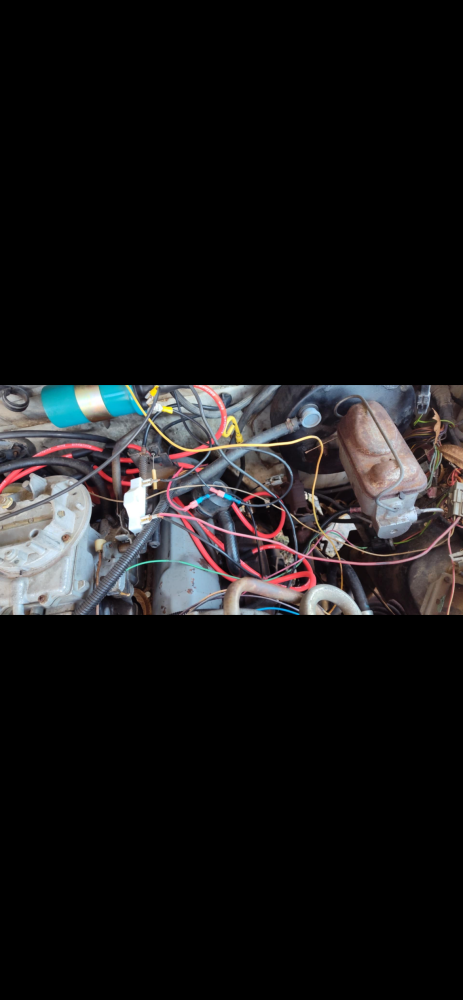

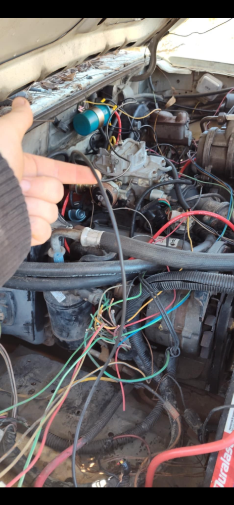

I think I may have messed something up. I know my ballast needs grounded so I’m going to do that, I had the red crank/run wire going through the ballast, then to the positive side of the coil, other side of the positive going to the
