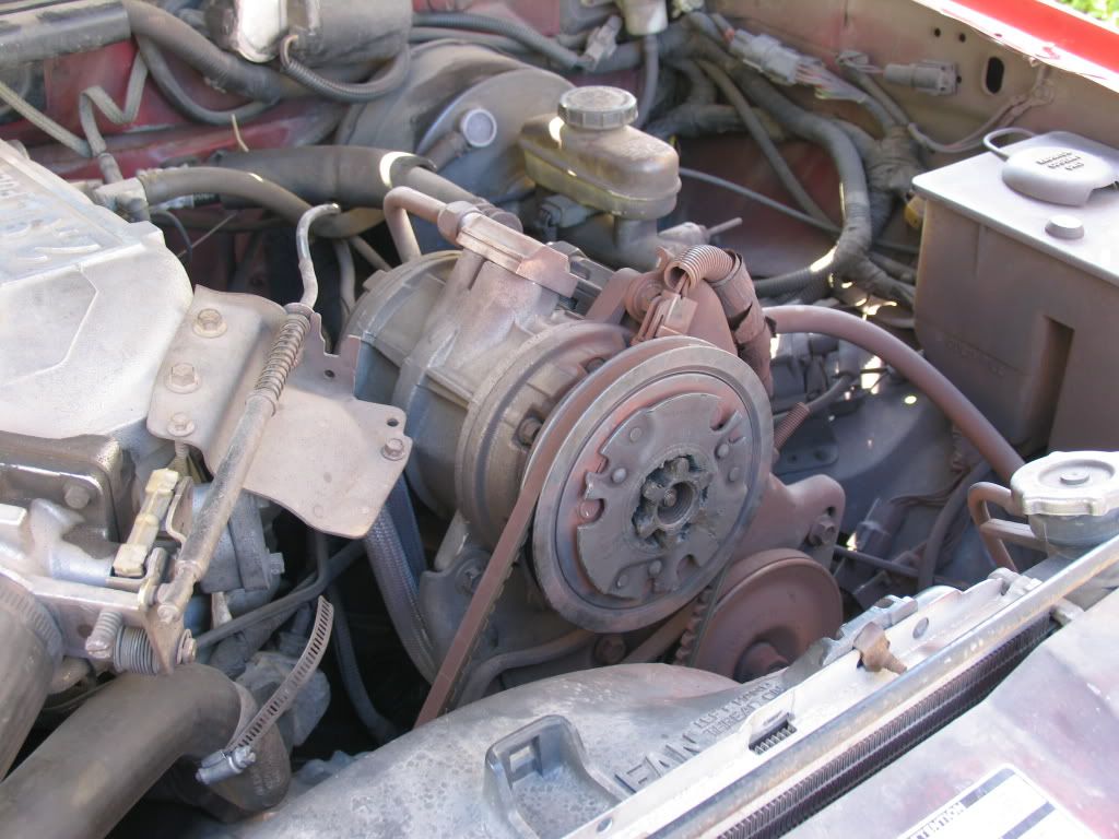

Also, my compressor has decided to eat itself up. The rubber that bonds the center and outer part of the clutch has torn. (see pics) You can see a rusty powder covering the engine bay. I pulled it apart yesterday and they have very deep grooves cut into each side, so it's pretty much toast.
Does anyone know of a cheap place to purchase just the clutch? Or, anyone here have a dead compressor with a good clutch they want to get rid of?
