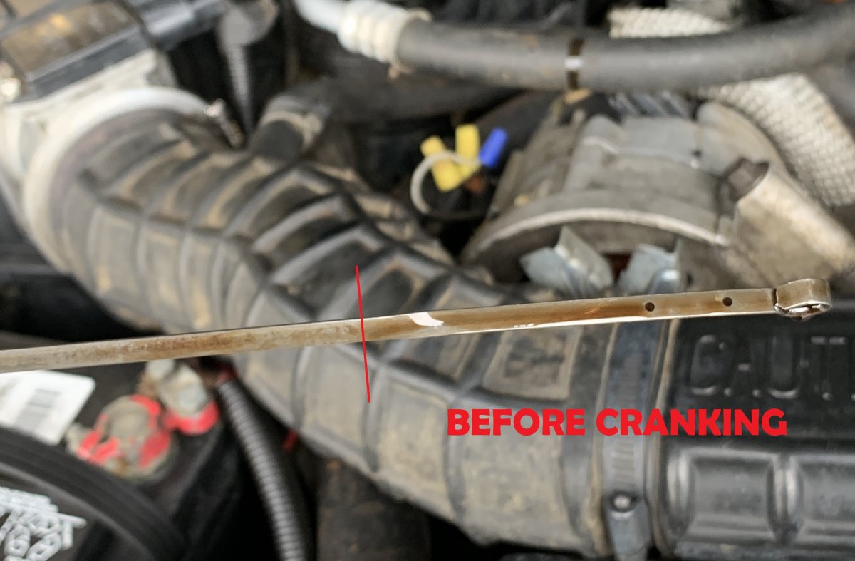

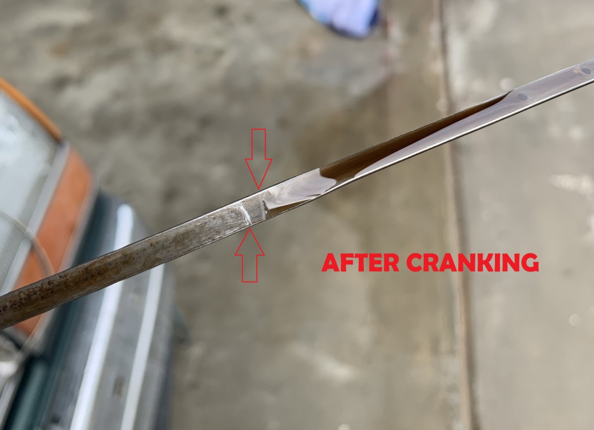

Well, I have some encouraging news... I couldn't get the truck started (Bad Fuel Pressure Regulator - Parts on the way) but I did crank it a few times trying to get it to and checked the level anyway. Looks like the level dropped a bit which means the pump appears to be working, it is SEVERELY overfilled though. So I think I'll drop the pan and start poking around and inspect the linkage to see if I find anything before I drop the trans out of it.
