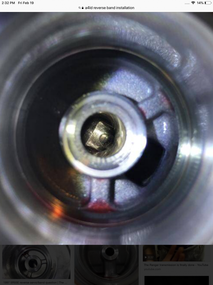

1 - when I put the rear servo back (without spring) it did not want to go in, even pushing hard, turning it and playing a little with suddenly it went in, I removed it and I didn't see anything that could prevent it from entering, could it relock?

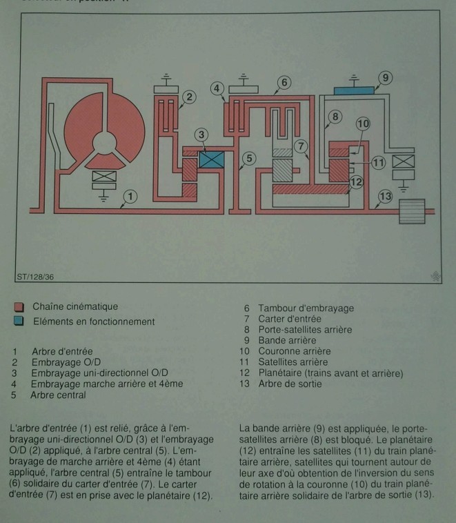

I found that but it's in French it says that the od is activated for reverse gear
55819
The OD one-way clutch(sprag) is "holding" when in Reverse, but it does that in ALL gears except OD
So I would expect forward gear issues if that was the problem
Very easy to miss the tab on reverse band when installing servo. Band will rotate and move forward out of location when building transmission. Can be moved back into location while transmission is installed. Need to see the tab of the band where servo pin installs.
Brad
Thanks Transman, I have already withdrawn the piston three times and tried with a Phillips screwdriver, the band comes out, despite this that it could be put on badly?
is it true that it does not slide well, when I push it in, it does not come back easily, normal?

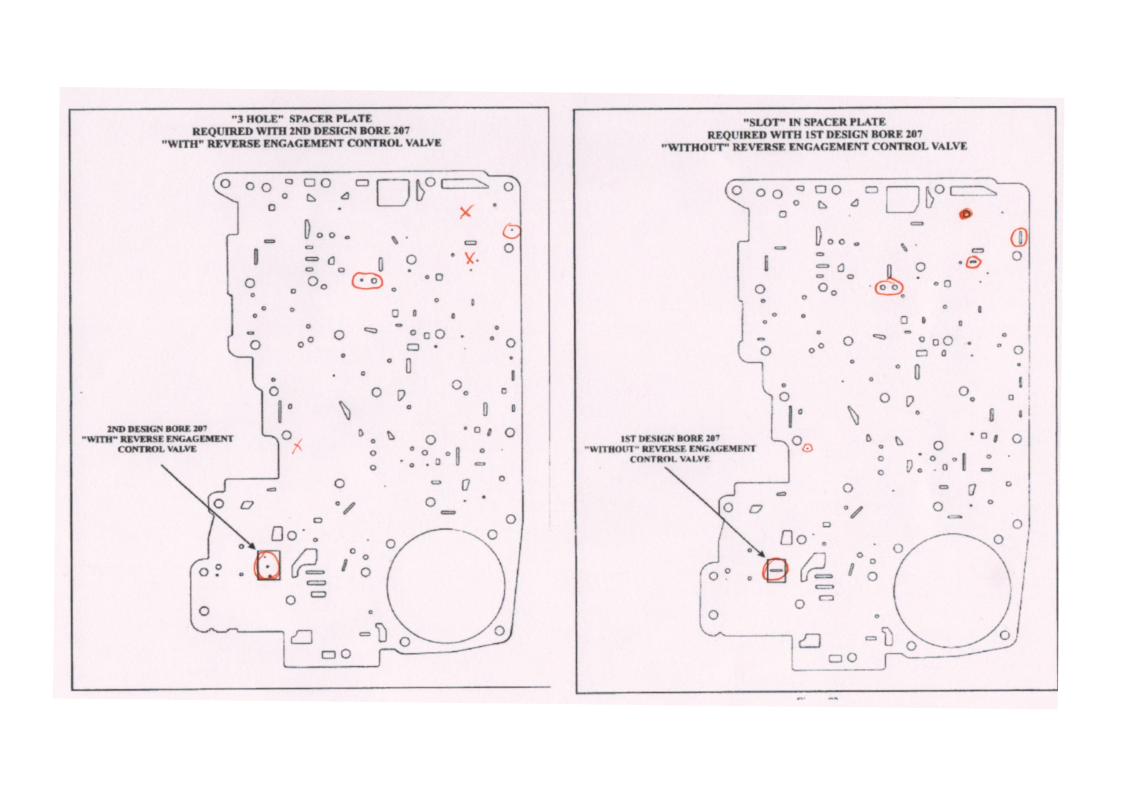

last news I removed the valve body to check all the springs and valve, everything looked correct but the seal of the separator plate was damaged, I took the old plate or the seal was in very good condition now I have no more power neither in forward nor reverse, by searching a lot, I found that these plates were not all the same (see photos).
Could this cause a power problem?
