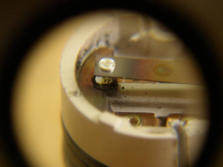

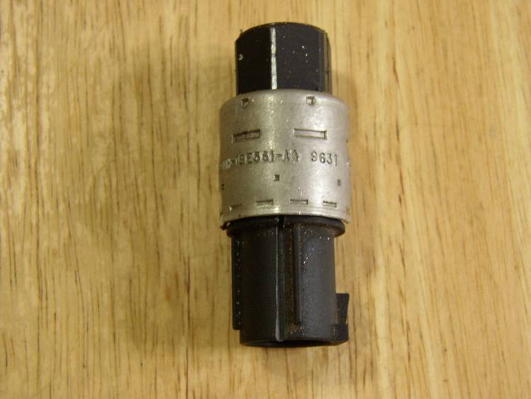

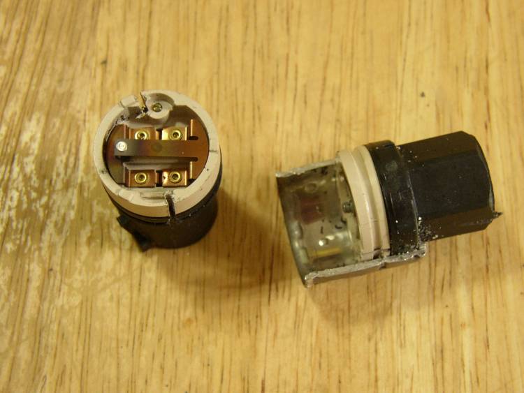

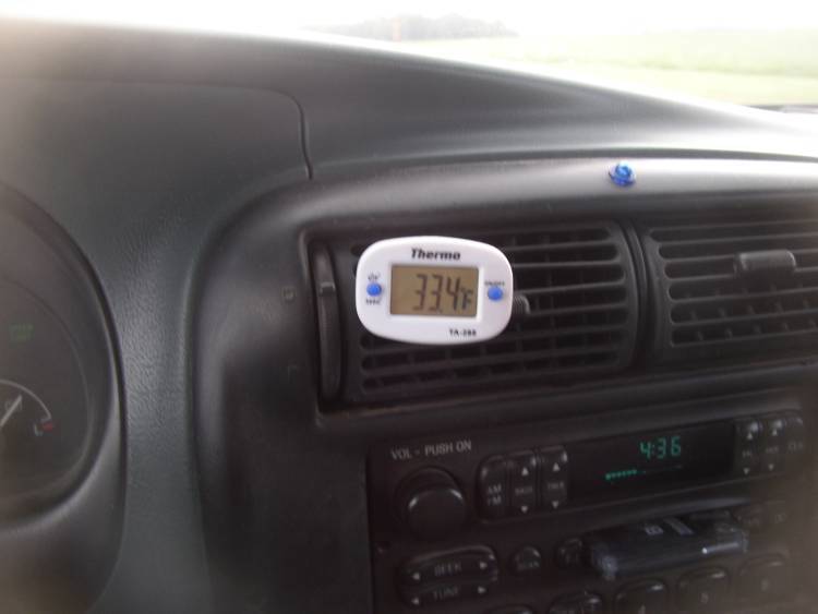

My AC was intermittent,sometimes cold,sometines mid-50's degree-wise.
Gauges said everything was ok when checked.
Low pressure switch checked good(at the time I checked it) I replaced it anyway,low cost try and easy to do with no refrig gas loss. Mid 30's now!
Been three weeks now since the fix. This may not add anything to the thread but it can't hurt(I hope).
