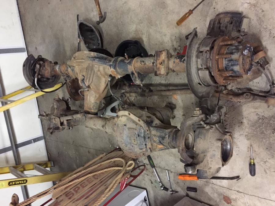

The rangers getting SAS'd! Got some 03 super duty axles that i just started building. I decided that since i couldnt get rid of my beloved ranger and i missed having a wheeler that she was getting some 1 tons.
Just got the front regeared yesterday, put some new u joints in today and started cleaning it up. Hopefully i can have the rear regeared by the weekend then its game on with cutting out all the IFS bullsh*t, should be fun!
The plan is 40s and leaf springs front and rear for simplicity and cost. Maybe down the road ill link it but this should get me going for now.

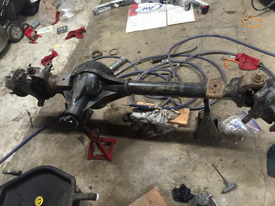

Heres what they looked like! Gonna paint them after all the welding is done to them.
