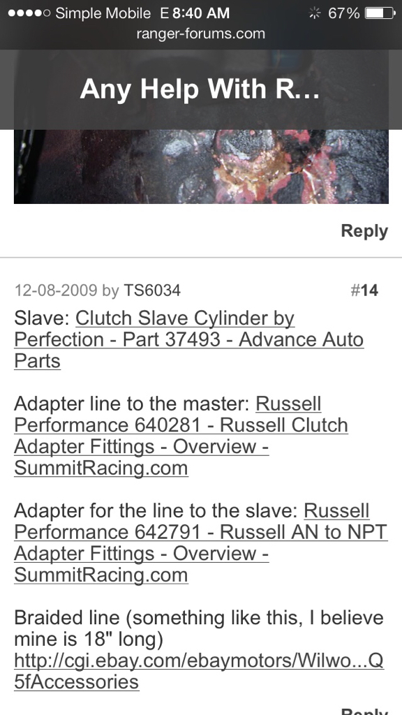

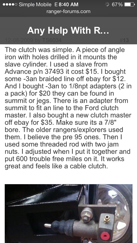

These are some screenshots of a post that I went off of the first time I made my clutch. But the one thing I didn't know, for the 98+ rangers you'll need to use like a 99 F-550 master cylinder and open up the hole in the pedals that the master cylinder snaps into. And you also use a stock ranger size pushrod in the F-550 master because the one that comes with it is too long. This method has worked great for me and will be 10x easier than getting a cable clutch setup working.
