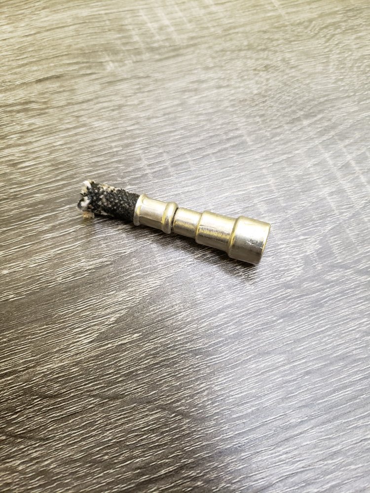

So was changing my fuel filter and the "quick disconnects" were anything but quick and ruined them. Went to dealer and they dont have the part so before I go to auto parts store does anyone happen to know what size fuel lines does it use 5/16 or 3/8? And if anyone else had similar situation do they have a replacement dorman part #???? Thanks in advance

All fuel injected Rangers used 5/16 fuel lines
You may need to splice the lines because they are too short after cutting off bad connectors
Usually you heat up the nylon fuel line, heat gun not a match, lol
The heat makes it pliable so it will stretch out a bit so you can slide in the splice or new connector, when it cools down it shrinks for a tight connection
You can use just a connector on one end of the cut line and then a connector with short line and splice on the other end, filter is just moved over one way or the other

I see its a 1999 so it has 3 port fuel filter?
My filter only has 2 ports. will do as you suggested and use a heat gun lol even though a match would be more fun. Think this would work? https://www.dormanproducts.com/p-28963-800-050.aspx
Lastly should I get some 5/16 clamps for the connectors or once it has cooled does it provide a sufficient connection?
At work, we don’t let the guys heat the lines with a heat gun. We use hot water, almost boiling.

Yes, I like the hot water idea, use that
Yes, I think thats the correct Dorman part
If you slide in the connector or splice far enough no clamp should be needed, but up to you really
