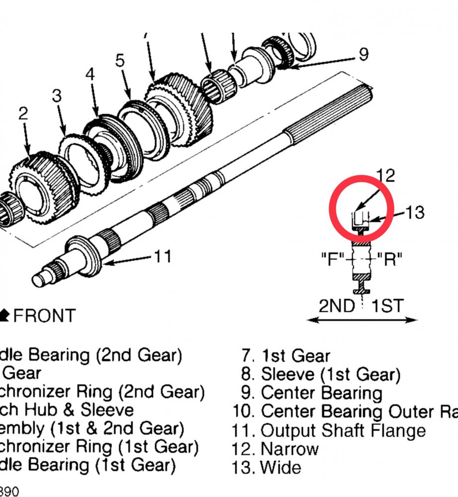

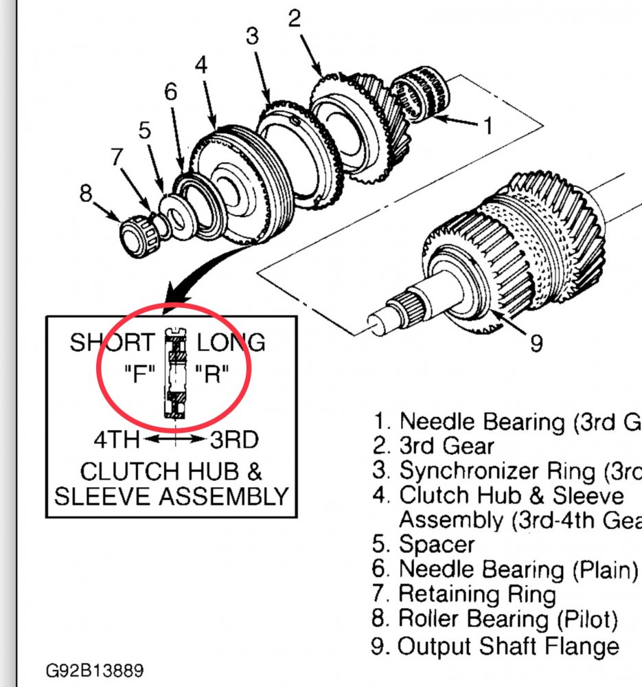

Double check that the sliders/sleeves got installed in the correct direction.
