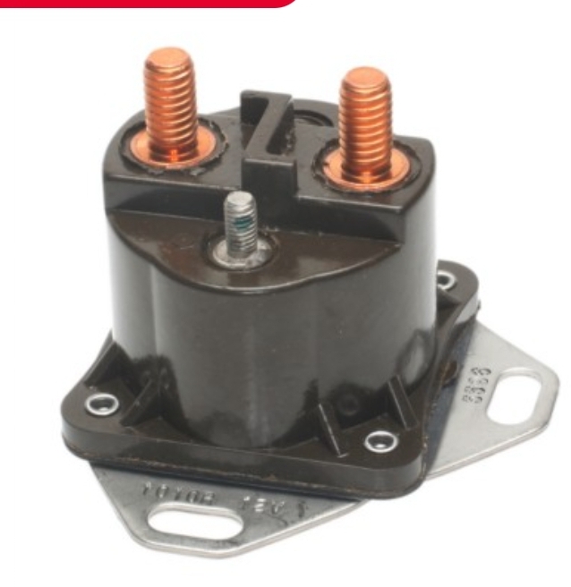

So this is what I'm calling the solenoid. Is this what you all are speaking of as well? Think I should start by replacing that? Or by relay do you mean a plug in the fuse box?

That is the starter relay. The starter solenoid is built into the starter itself. If the starter works reliably every time you short across the 2 big terminals on the starter relay and the relay clicks when you turn the key, then the starter relay should be your priblem.
Yup. They can get corroded inside so they don't make contact if they sit for awhile.

So today I was piddling and wired up a toggle switch to the starter relay so I can crank it until I get a new one and see if that the problem. Works perfect.. Haha
The only solenoid's I can find have 4 posts and my OEM only has 3. On the new solenoids one of the small posts are copper colored and the other one is not. That extra post is a problem because of the wire harness that bolts on the side. I guess I could maybe grind down one of the small posts and see if that harness would then fit but im not sure that's a wise move. Maybe then cover it with epoxy or something so it wouldn't arc of something???
Anyone have any info for.this?
