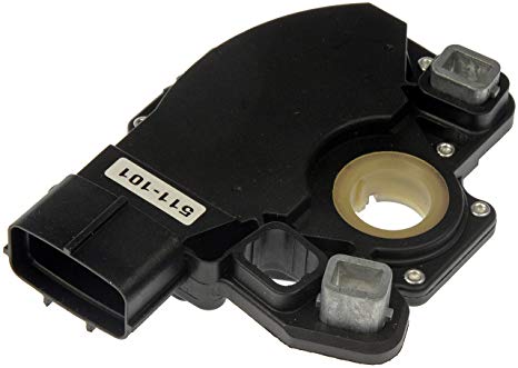

My truck has a bad transmission range sensor and its always running with the O/D light flashing, otherwise it falls in and out of gear constantly. But i've had it for almost a year and it just started doing this a couple months ago and I believe the park safety is a seperate switch from this thing right? My fat arse won't fit up that far under the truck and still have enough room to work so I'm just going to have the shop do it when I get the rear main seal done and the trans will be out anyways. Just to be clear the park safety is a seperate and independent system from this thing?

I did some searching and it seems like the park safety issue is a pretty common issue with all ford column shift vehicles? I found some youtube videos showing the repair being done on other vehicles and much newer Rangers than my 95 but I couldn't find anything up under the dash that looked like the two screws they were supposedly tightning. So far I've always been able to get it running by shifting in and out of park/neutral/drive for a minute and sometimes rolling the truck back a bit. Also when the truck rolls back after being put in park I can see the column shifter jerk sometimes? Is that normal? The main concern is sometimes I get it started the very first try, sometimes I just have to move the shifter down and up once, and sometimes I have to spend 30 plus minutes fiddling with the shifter, moving the truck, etc.

The range sensor is the neutral safety switch. Replace it. Problem solved.
