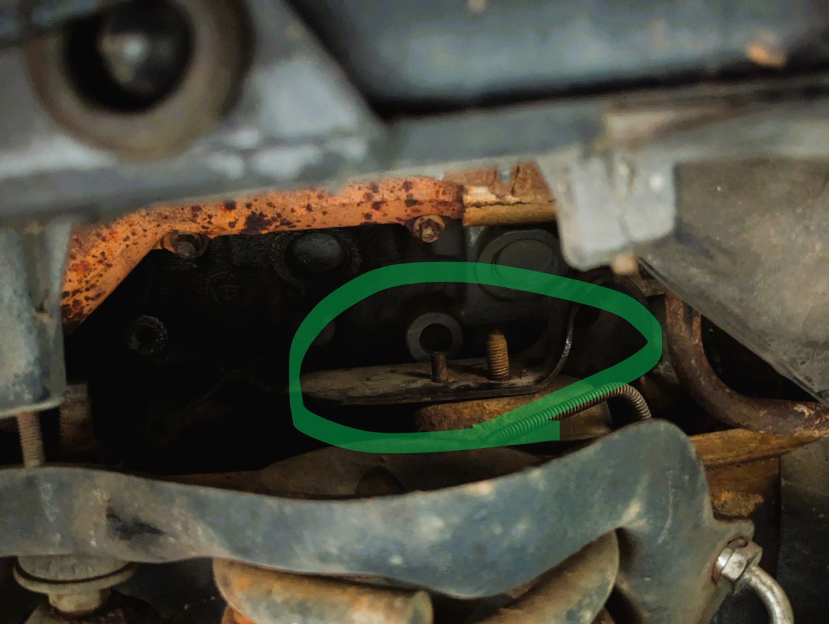

View from above passenger side wheel:

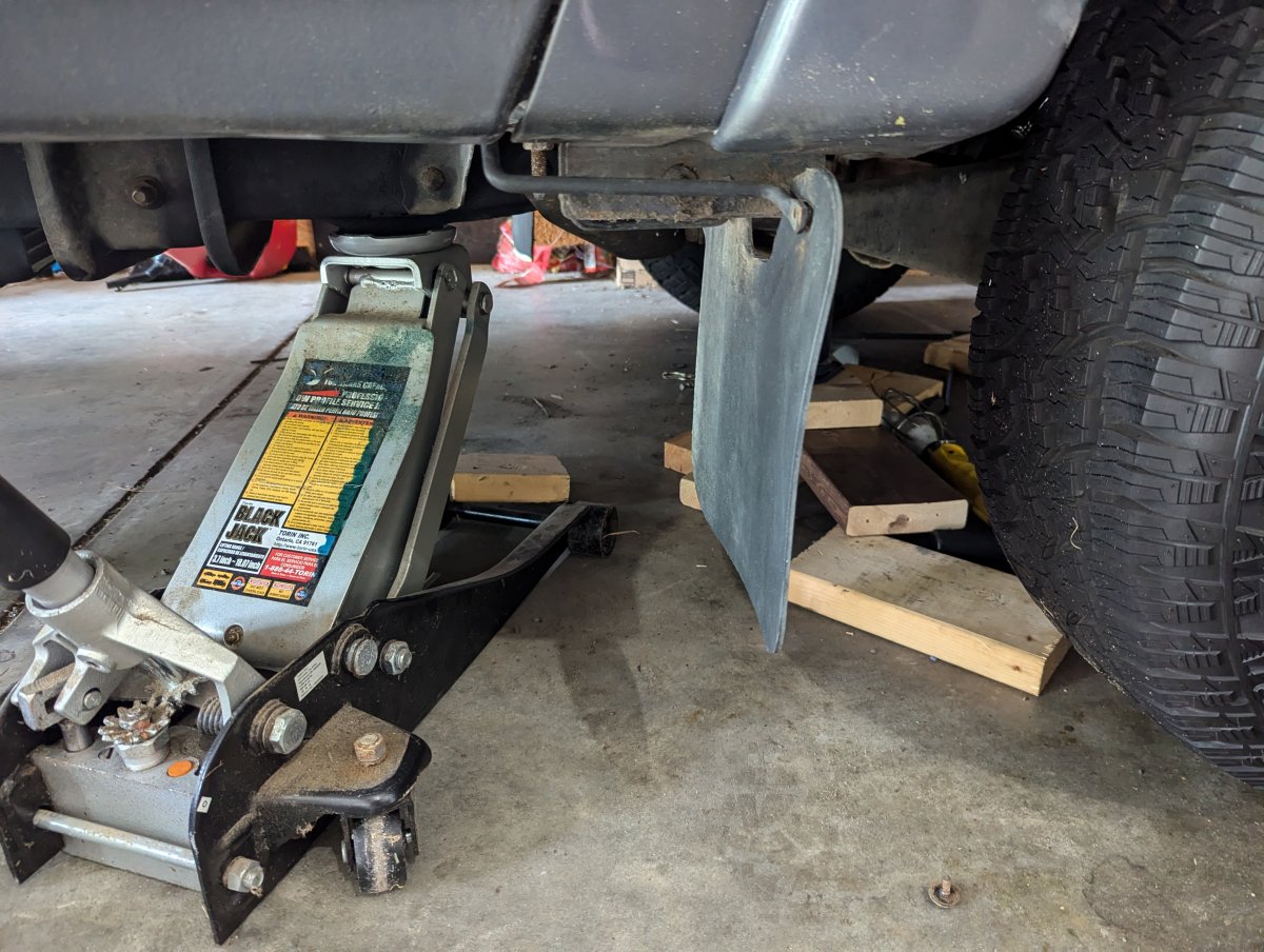

-To remove the nut on the bottom of the mount, I lifted the passenger side of the frame a few inches, the tire was still making contact on the ground:

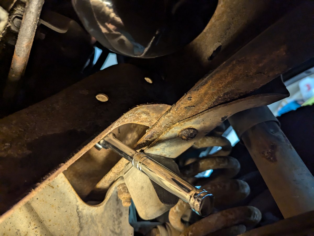

-Then I used a 3/8's flex-head ratchet and a deep 18mm socket and the little bit of suspension droop gave me enough room to snake the ratchet in from in front of the oil filter:
*This picture is taken just below the oil filter, you can see out the passenger side wheel well*
-This gave me JUST enough room for one click on my 72 tooth ratchet. There was enough room to get a cheater bar in there as well since i could only get two fingers on the ratchet itself.
