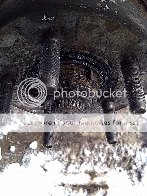

ok boys I finally made it up our 1/4 mile long driveway (curse the snow!!) to my spot so I could get the tire off. I took it and the hub off to get you guys a picture of the way things look. My driver's side looks exactly like the picture you put up junkie. Unfortunately this is what the passenger's side looks like..sorry about the grease.
any ideas?:dunno:
mkay, I'll drum up some clips then. or as ford calls them snap rings..I was very intrigued to find that out. anyway though, is it really as easy as prying/pulling/pushing/jiggling/wiggling the axle out far enough and popping the clip on?
Yup, get in behind the U joint at the knuckle and pry the shaft back out so you can see the groove in the end of the shaft that the clip rides in.
