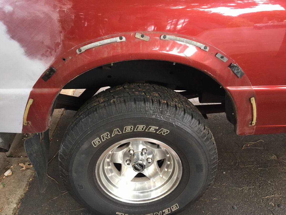

Hey guys,
Does anyone know if the clips & hardware used to hold the fender flares on the 93-97 Rangers can still be bought new? Or has anyone come up with their own hardware for these?
61433
I'm doing some body/paint work on mine so I took the flare off, and when it came off it left all of the clips and hardware in the bed rather than coming off with the flare. I'm afraid to try and remove the black plastic clips because I feel like they will break easy and I'm not sure how easy it would be to find replacements. And the yellow plastic retainers towards the bottom on each end, anyone know if new replacements exist or what to do if they break when trying to remove them? I'm assuming the only way I'm going to get the flare back on is by taking all of the hardware off and put it back on the flare before installing it, I can't see a way you could slip the flare around these clips/retainers with them on like in the picture.

Yeah I tried to look up videos on it but they all were on newer trucks and they seemed to be attached using different clips and hardware than these. The idea with the sheet metal and bolts is something I'll have to keep in mind though, thanks!

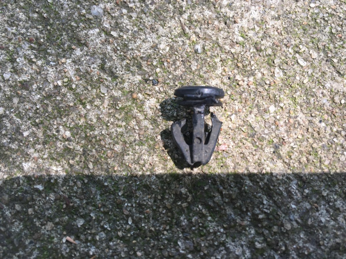

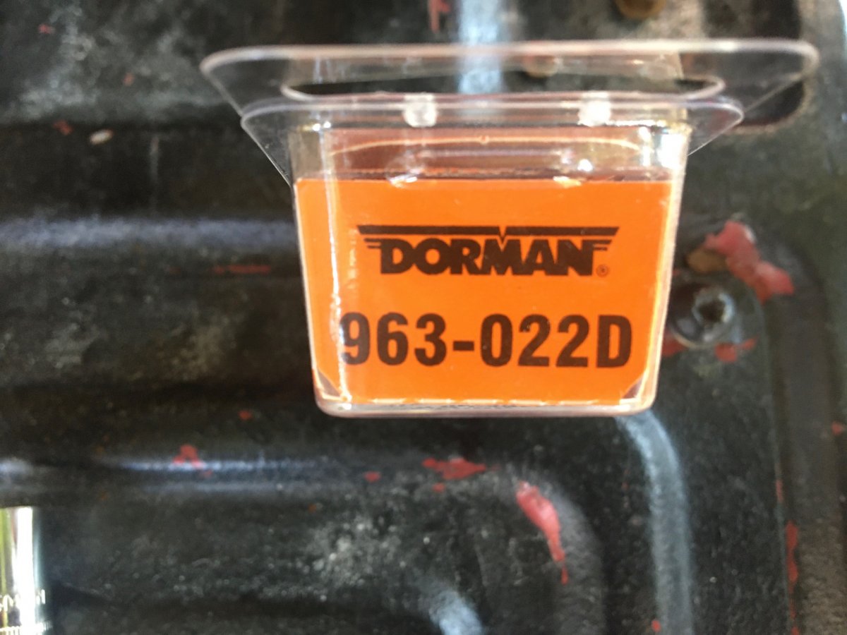

So some of the clips you can. I'll have to take pictures later to explain better, but the ones that push in on the bottom of the flare are that type and I found Dorman replacements because all of mine broke when I pulled them out. The ones that you can see in my first pic are a little different - they also have a groove in them that the metal tabs slide into, if that makes sense. I'm not sure how common clips like that are. I'll be attempting to put the flare back on in a few days so if I break any of the hardware and have to get creative you'll hear back from me soon! lol

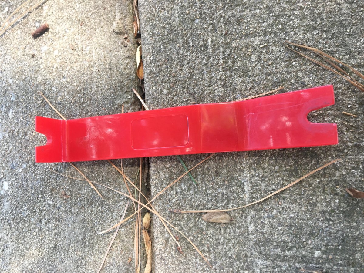

The black plastic clips that are in the bedside in my first picture with the metal tabs on them look like this. I'm not sure if you could find replacements for them if you break them, but I was able to pop them out carefully with this plastic trim tool pictured below. If you take your time, you can get it at the right angle where it pops one of the tabs out first and then the clip comes out easily without breaking. Just take your time here figuring out that angle so you don't just break the clips.
Lastly, the clips I was referring to in my previous post. There are 8 of these, and if they break off it's not a big deal because Dorman makes replacements. The part number is 963-022D.
