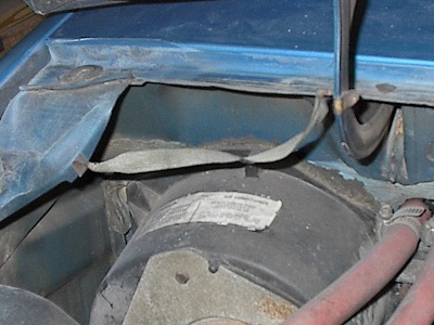

Check that your hood is grounded with a strap, like this factory ground strap on a 1st gen Ranger:
The hood keeps the ignition interference from going straight to the antenna. If the hood is not strap grounded, it could be grounding / ungrounding through the hinges and latch (with vibration from truck movement and the running engine), and being picked up sporadically on the AM band like you describe.

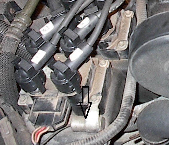

And check that there's a noise suppression capacitor on your coil, like this one a '94 dual plug 2.3L:
These items are mainly for improving AM reception. I hope that you find a simple fix, but it's probably just old age catching up with radio itself.
