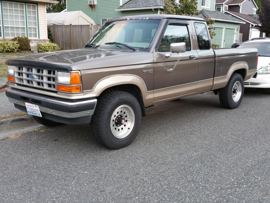

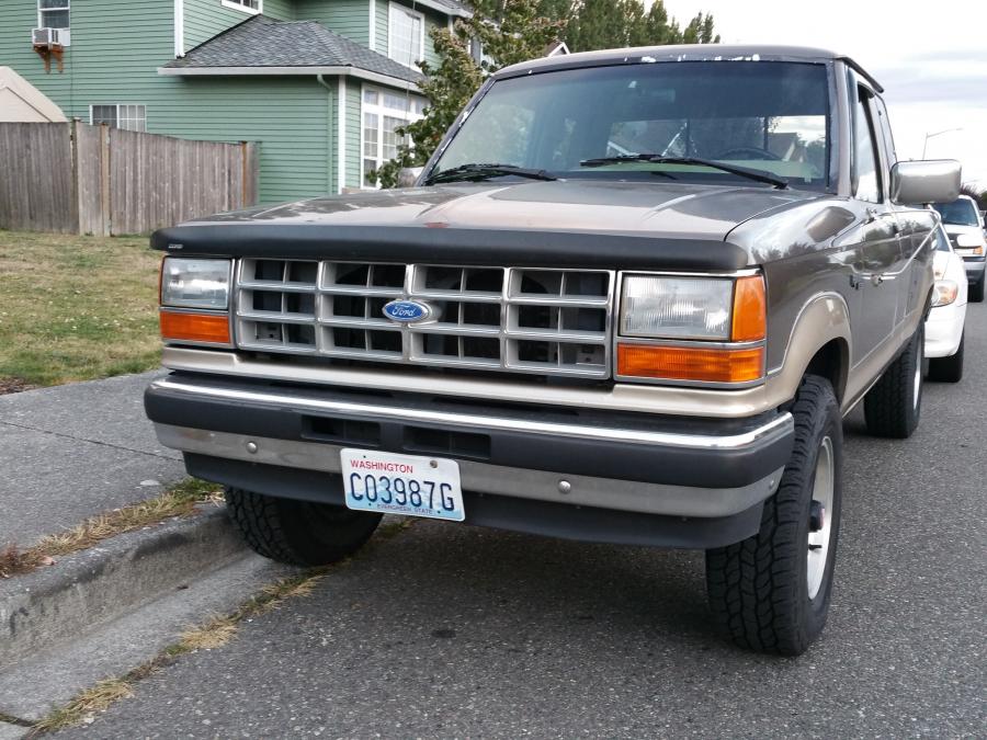

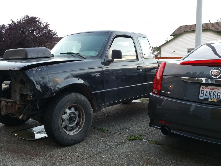

Yes, the '96 seems to need more than a little body work :)
'89 is very nice well worth the swap :icon_thumby:

Clean '89 ya got there!!
I'm thinking it must've been an early model as it still has the manual t-case. My father had an '89 that came with the electric t-case.
Dad also had a '96 I could've taken for a swap but seemed like too much work for a 4.0. Haha
Good luck with the swap!!

Thanks on the compliment. I actually really scored with it. I found it on CL and I wasn't even looking for a truck. It was listed as blown engine *because his mechanic said it had dropped a valve* and it had been parked for 4 years.
I picked it up fully expecting to repair / replace the engine.
Well, the engine wasn't bad!

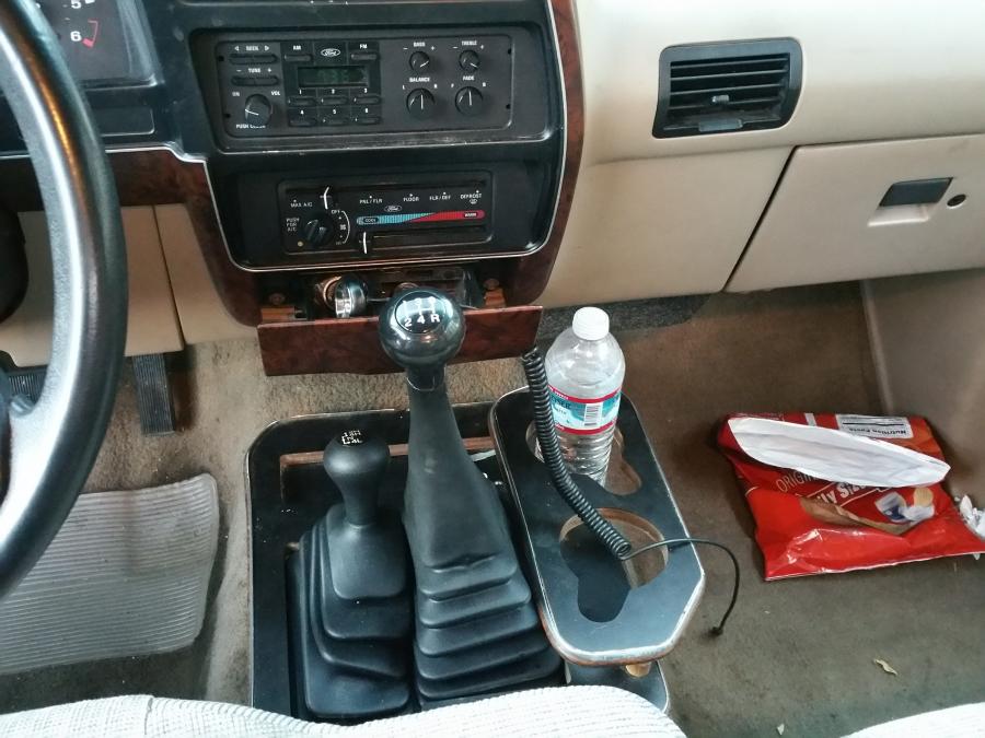

After looking over your pics, it looks as though someone swapped in that manual t-case. Floor does not look factory and I'm pretty sure I can see the 4wd buttons in one of the pics.
The manual transfer case is factory. I put in the 4x4 buttons and have one re-purposed for an air horn and the other isn't being used yet. In fact the plug for the push button 4x4 is absent on this truck. If you notice I also installed the rear wiper button + defroster button from an explorer. They are also being used for accessories. I like to try and use factory buttons / holes vs drilling new holes for toggles.
That bezel around the shifters lifts off. Someone made it out of wood and I must say it works very well. I'll take better pics of it sometime for others to see how someone did it. I wish I had those fabrication skills.
