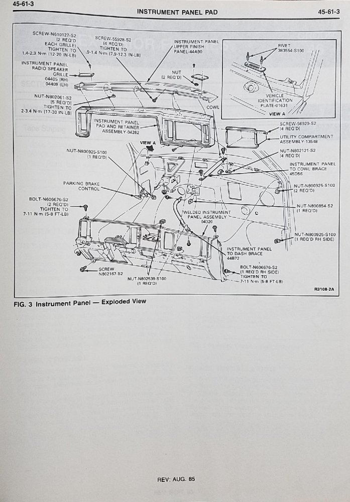

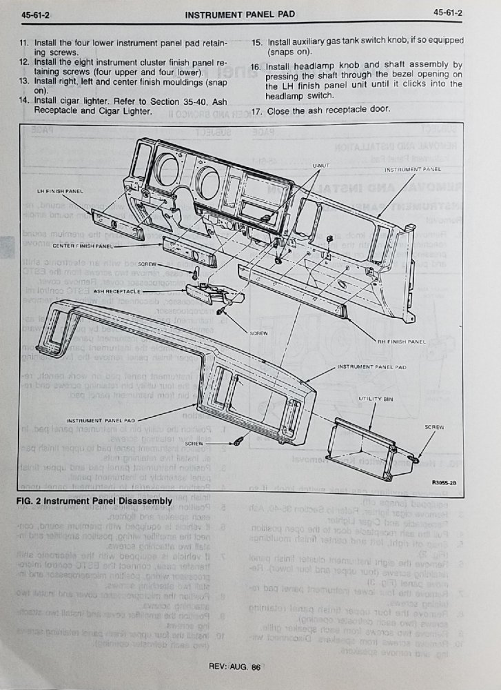

I've never taken the dash pad out before, but here are the relevant pages from the 1987 Shop Manual.
