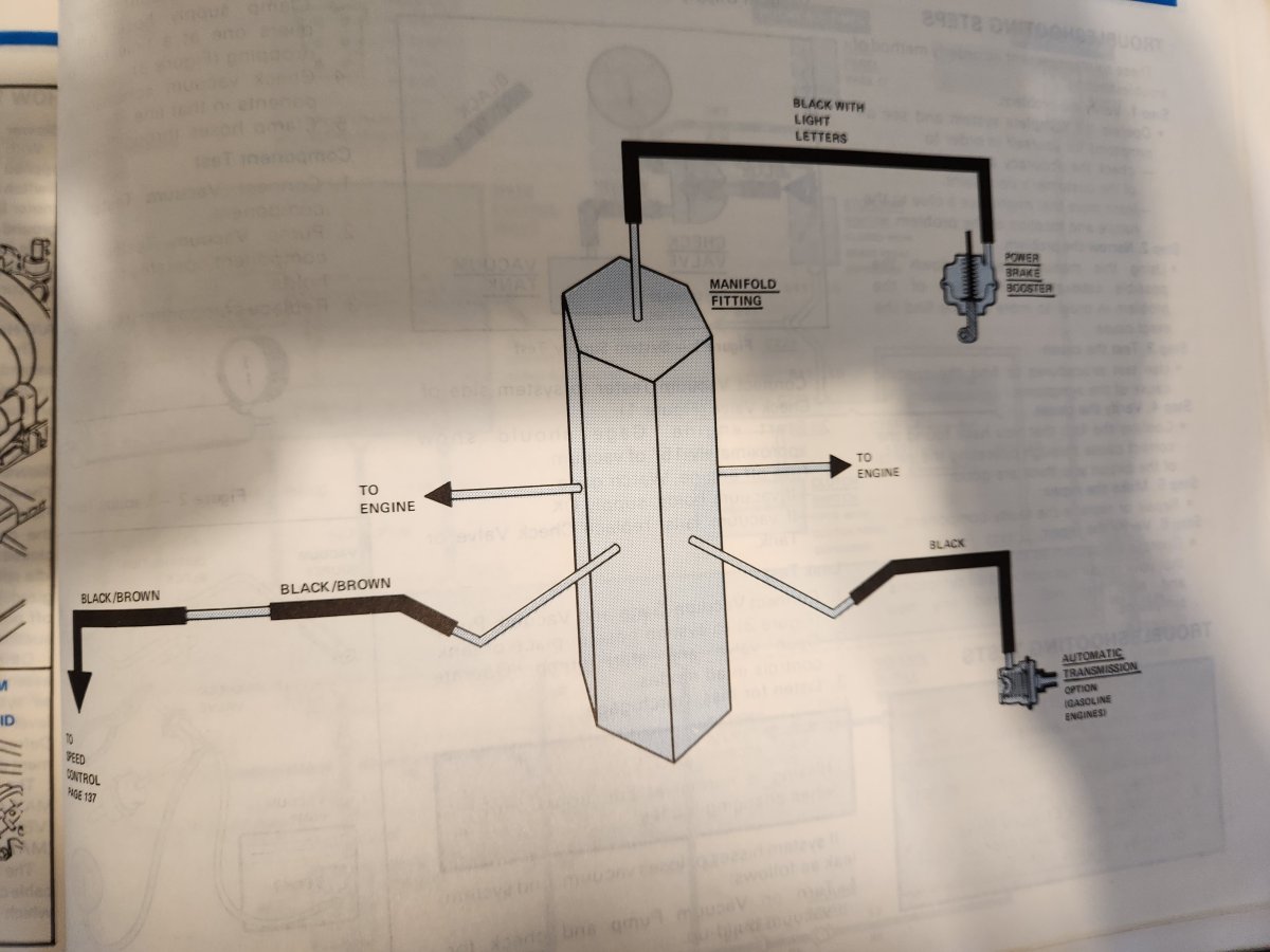

A few weeks back I decided to replace the injectors in my bronco and, to make it a bit easier, I removed the intake to get better access to the fuel rail. When I went to unbolt the egr valve from the intake one of the bolts snapped and I can't seem to find a replacement. After putting everything back together (minus the egr since I only have one bolt) I also realized that a couple of vacuum lines weren't plugged in to wherever they originally went. All of the lines for the intake are plugged in to their respective connections, I just don't know where these other ones go. Any help on either of these two issues or tips for working on/maintaining the truck would be appreciated.

The EGR (which I am still replacing cause it sat for about 20 years) and its line and pipe are fine and I know how to install them, the problem I'm having with the EGR is that one of my bolts for it had snapped off when removing it to get the intake off. I got the broken bolt out by welding a nut to it but I can't seem to find a replacement anywhere and it doesn't seem to be a standard bolt size. The issues with vacuum lines are with a few different lines scattered around different sections of the engine bay and I have no clue where they plug back into because I've already reconnected the ones that go to the intake onto their respective posts. I really appreciate any help with this nightmare of a project, some things just keep going wrong.

So I realized that an old 01 town car that I have has egr bolts that are almost identical to the ones in my b2, the only difference is that the ones from the town car are slightly shorter in length but I'm guessing that it should be fine. Since the town car is already sort of trashed and destroyed, except for really anything in the engine bay, I'm considering looking into putting the 4.2L v8 from it into the b2 but I probably wont cause of the amount of work. Now the only issue I have (with the engine bay in the b2) is the vacuum lines that aren't hooked in.

I appreciate the info, the lines that I’m having problems with aren’t for the egr. To be honest I don’t really know what they’re for but they’re on the same side and area as the air intake/filter.

That's really simple. Brake booster, modulator valve, and cruise control servo.
Pretty sure there should be Evap and intake temp flap there somewhere at least.
