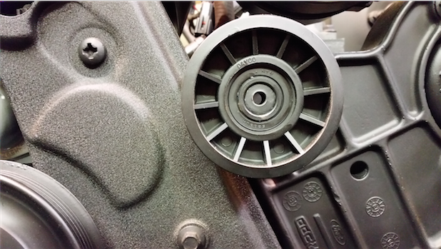

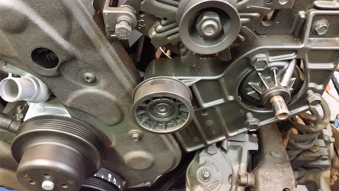

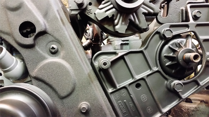

Didn't get a chance to get to the yard, but here are some pics of the pulley and pulley bracket. Just to refresh I'm looking for the pulley bolt.
also the pulley has a part number/name is Dayco 00039.

You have to accomplish two things. Align the idler front to rear so it is in plane with the other serpentine pulleys and provide 'axle' services. If you put it in place, if you can, you should look for clearanc between the boss on the mounting plate and the center of the idler. If the idler can be tightened against the plate, then all you need is a regular bolt of the proper diameter, length and thread style.
You can measure the diameter, and use another bolt to determine thread requirements. You'd have to approximate the required length. I'd use a probe through the center of the pulley to the surface of the mounting plate.
If the pulley must stand out proud of the mounting plate surface, you will likely need a spacer slug that will get tightened by the bolt against the mount and against the center of the idler.
I make the assumption that this setup is from the newer engine rather than the trucks factory equipment. Maybe a turbo Bird site on the web might have a better solution.
