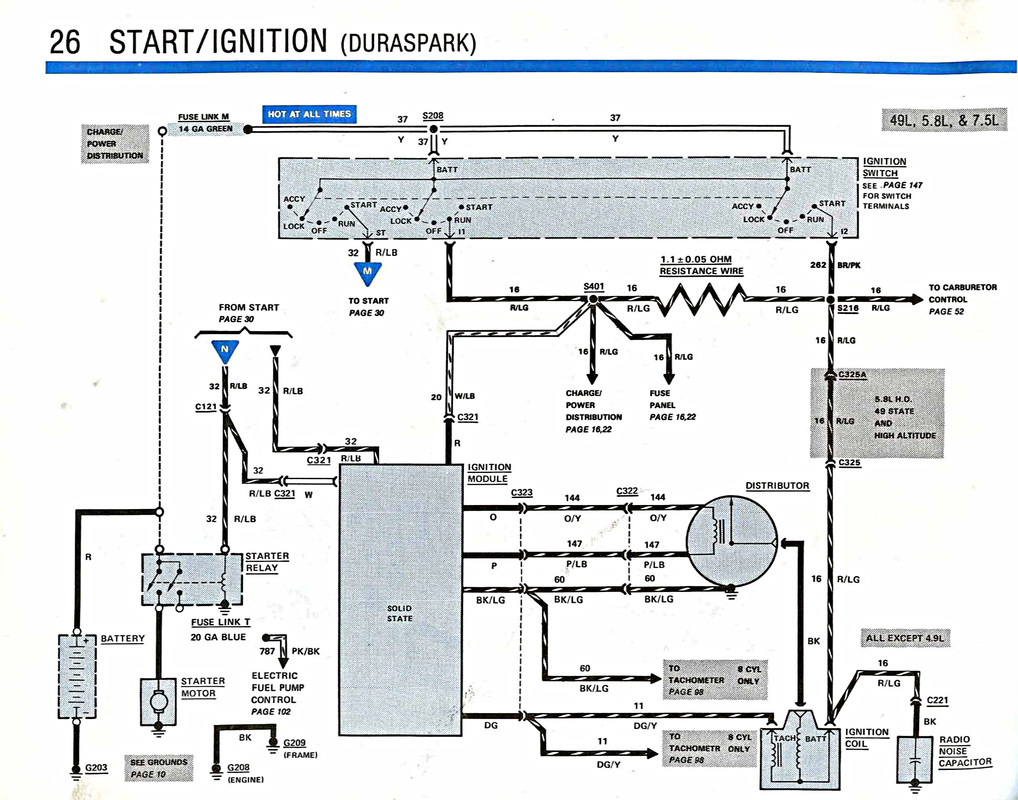

One thing I have been noticing and have a question about (hopefully I can get a good answer, solution or way forward) a voltage reading I've been seeing regarding power to the coil. Of the two wires that come off of the grey 8 pin connector. The two listed in the write up are present (brown/pink and red/lt green). I tapped in to the red/lt green wire for coil power. When not connected to the coil, I get a 12 volt (battery match) reading. When I connect it to the POS of the coil it immediately drops to around 7 volts. Is this correct? I thought it would still maintain a 12 volt reading. Any ideas would be really helpful. Thanks in advance.

You will not necessarily get 12v on the coil +. During cranking it's possible, though the starter zaps a lot of the voltage from the battery. During run the battery voltage is flowing through a resistor made into the harness. The coil does not get a full 12v in run mode in the original Duraspark II setup. Here is a diagram below of the duraspark II setup. It is from a larger pickup, but the wiring is very much the same on all the Fords, just the connectors may be a different number. You can see the resistor in the diagram, I have a 1984 Bronco II diagram and it's pretty much the same as the one below. About the HEI, the reason I used it was so I could use the square TFI coil and not have to use the resistor. Since you have already bought everything and have the correct coil, I would keep what you have.

Just make sure you use two of the original harness wires for the power to the module and the coil. That makes sure you have power during cranking and during run positions of the key. You can see in the diagram above in the old duraspark II system they are separate, one wire has power during cranking, the other has power during run.
The diagram below is for a inline 300 six in a f150, but that system is very much like our original computer controlled carbed 2.8. In the diagram below you can see they have a blue-white jumper wire to tie those two power sources together for power to the TFI during start and run. You can see in the diagram below it still has the resistor, but they are not using it. The reason they did the wiring this way, is so they could run either type of ignition in the vehicle, with just one main harness.
What surprised me is when I got the 1984 diagrams, the Ranger and Bronco are wired the same way, and they also have the resistor in the harness. I didn't think the Ranger or Bronco ever ran a duraspark II system, but maybe they did in Canada or somewhere else. For whatever reason, its in there.
