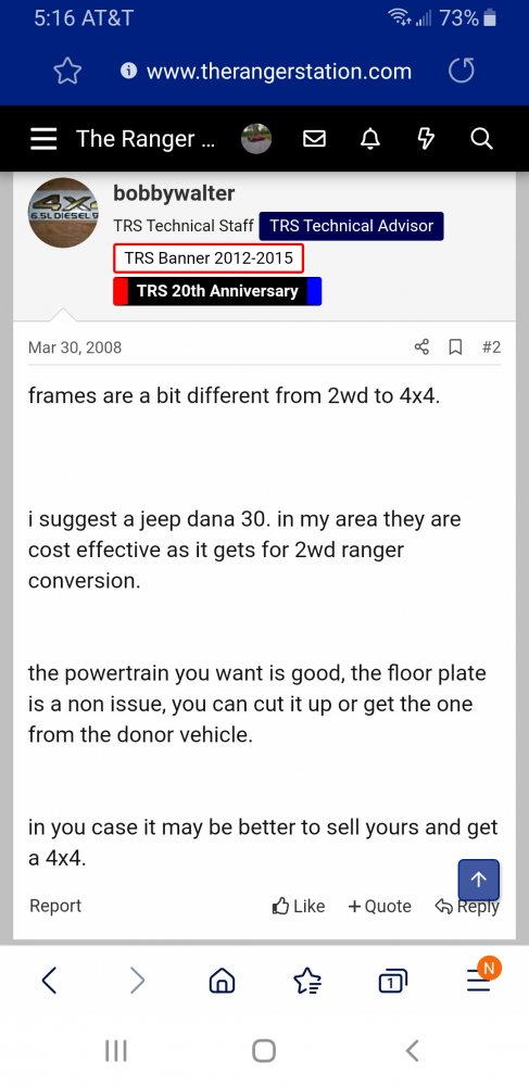

@bobbywalter
52924
What is this actual difference between the 2 frames from 4x4 to 2wd? Im planning on doing a sas swap.
The difference in frames is engine crossmember for stock suspension pivot brackets and the boxing of the passenger side frame rail in front of the engine crossmember. Some people get (or got, not common anymore) crazy and swap engine crossmembers and make theirs 4x4 with stock stuff, with your plans I wouldn't bother trying to find a stock 4x4... There's other little differences, but nothing to get crazy about, one isn't inherently stronger than the other

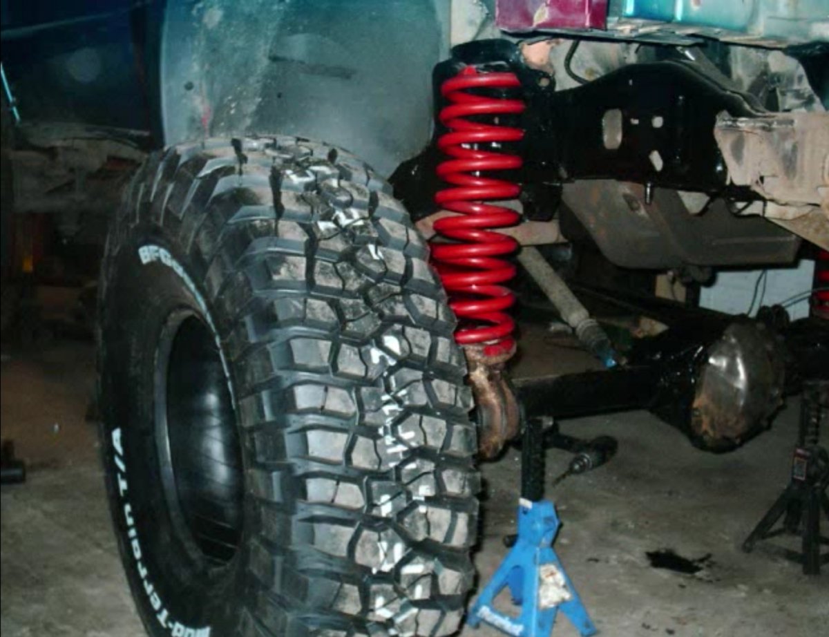

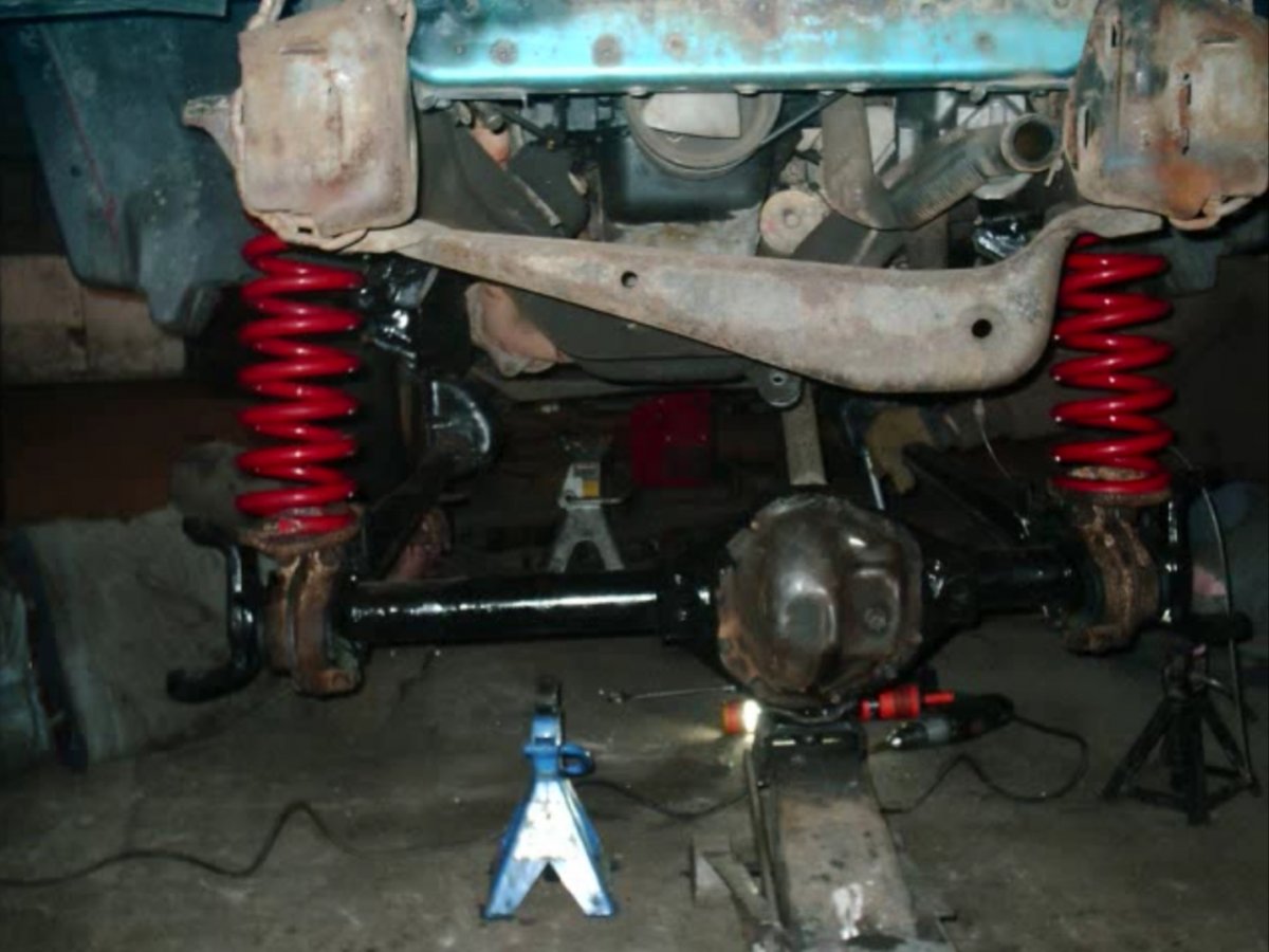

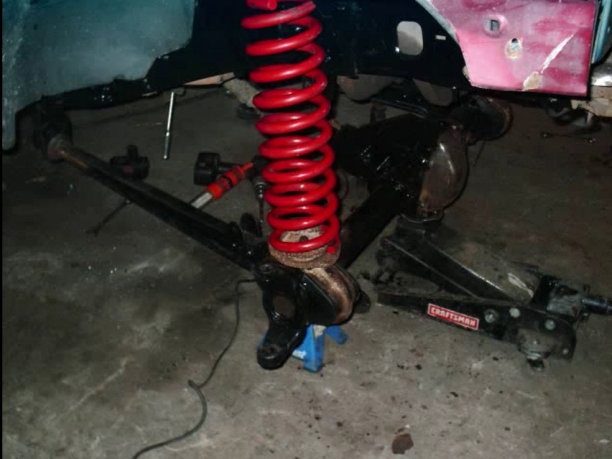

About 10 years ago or more I remember helping a friend do a solid axle swap from a early bronco. We made the frame rail into swiss cheese where the radius arms mounted. I remember we used revolver shackles in the back other than it flexing damn good not much else.
