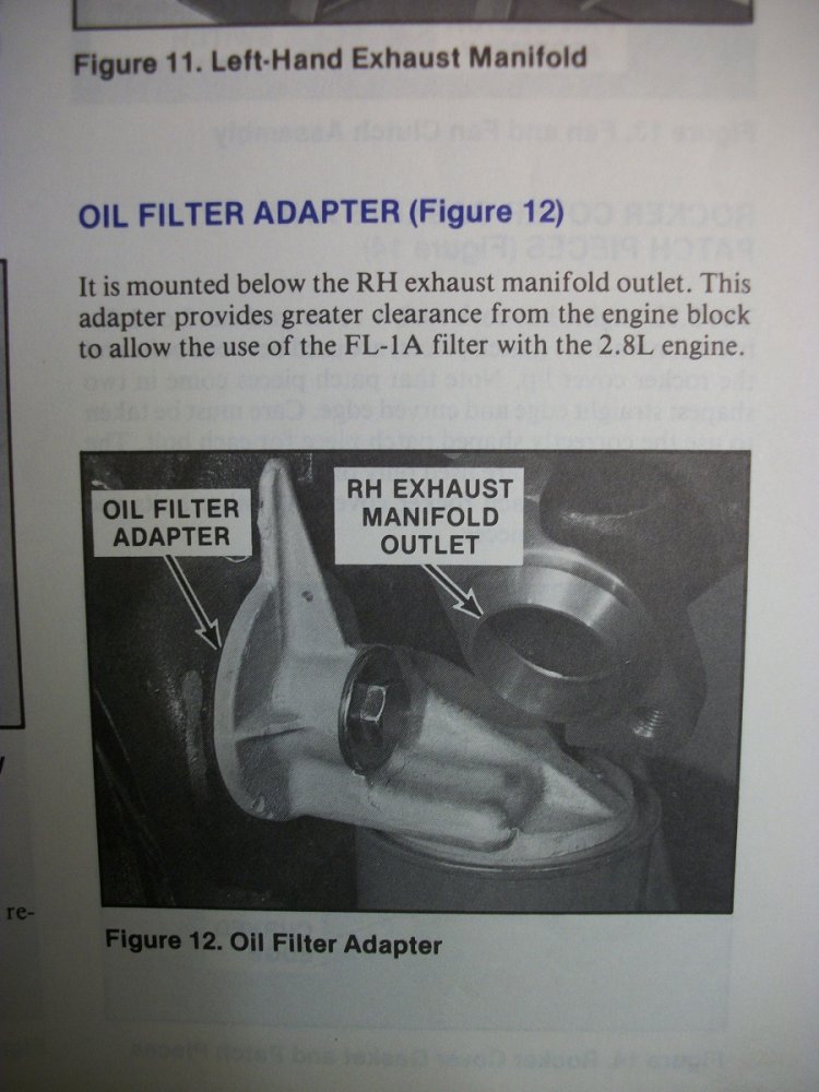

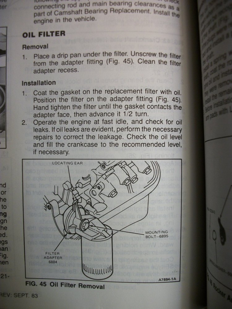

Well, I checked what Ford manuals I have, and there's nothing specific on the R&R of the filter adapter for the 2.8L.
I don't know if you can clear the filter adapter's sole mounting bolt with the exhaust Y-pipe in place. On a 4.0, with the Y-pipe dropped changing these O-rings is easy; but believe me, I do know that dealing with old exhaust bolts can really suck a big one. The bolt is hollow, so go easy on it; its torque spec is listed as 15-30 ft-lbs.
Good luck!
1984 2.8L intro training manual:
39990
And the 1984 Ranger and Bronco II shop manual:
39991
