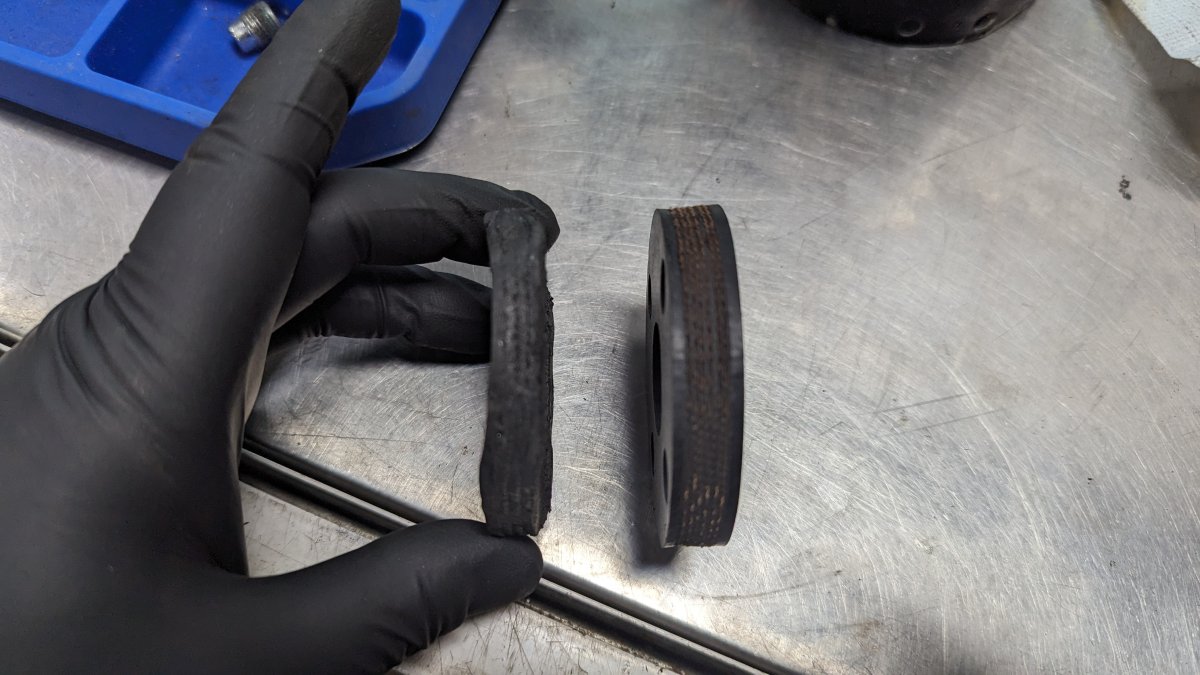

@dvdswan If I could possibly post a video, you'd definitely see what I mean. The young man I got the truck from thought the steering box just needed tightened. He drove the truck in this state for 2 years, and 20k+ miles not knowing that the steering coupler was literally about to fall apart. The rivets are just about the only thing holding the coupler together and they themselves are about to snap.
I test drove the truck like that...🙃

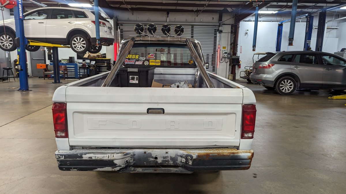

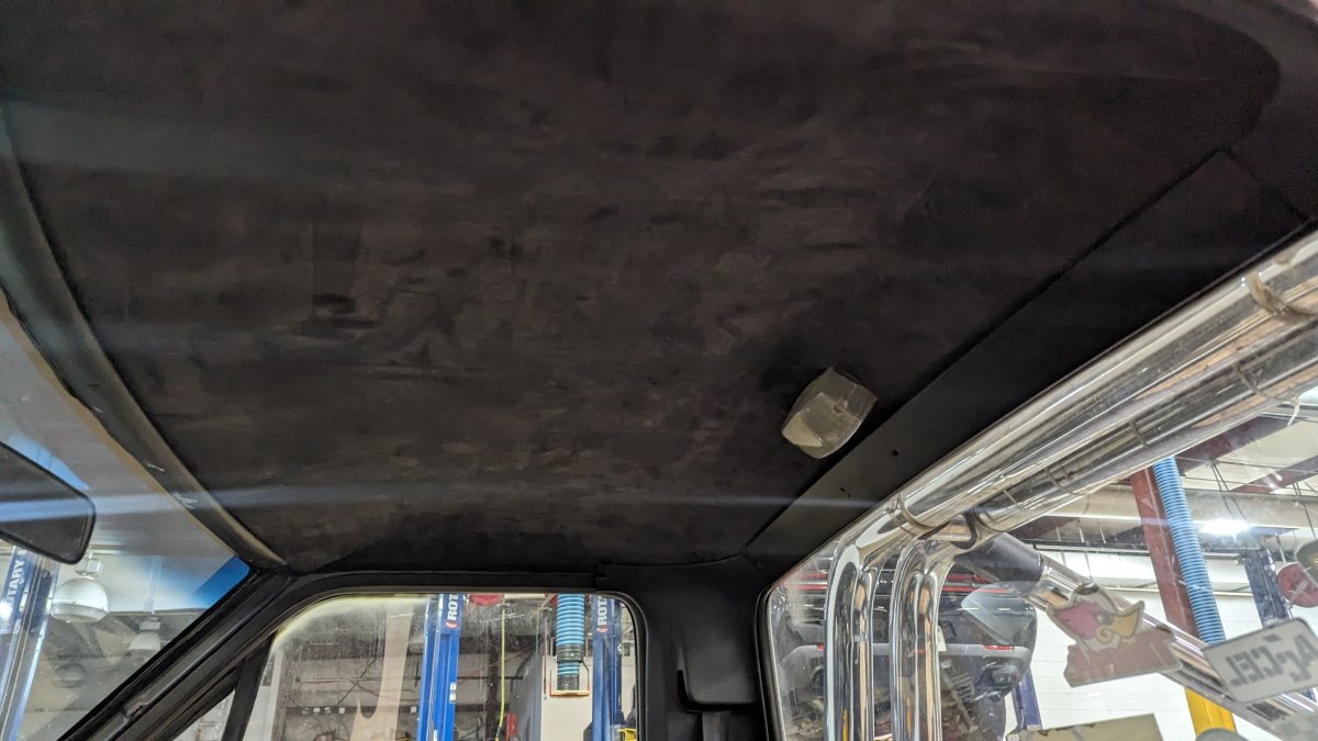

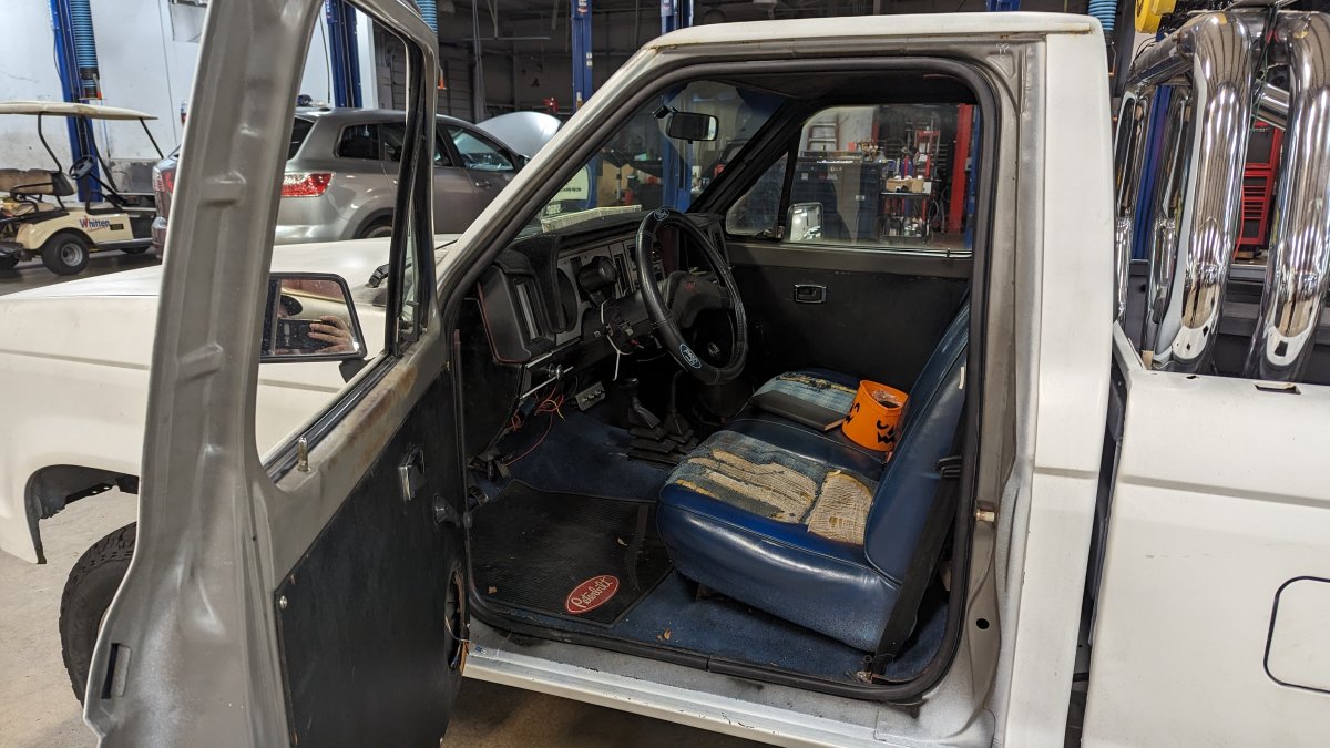

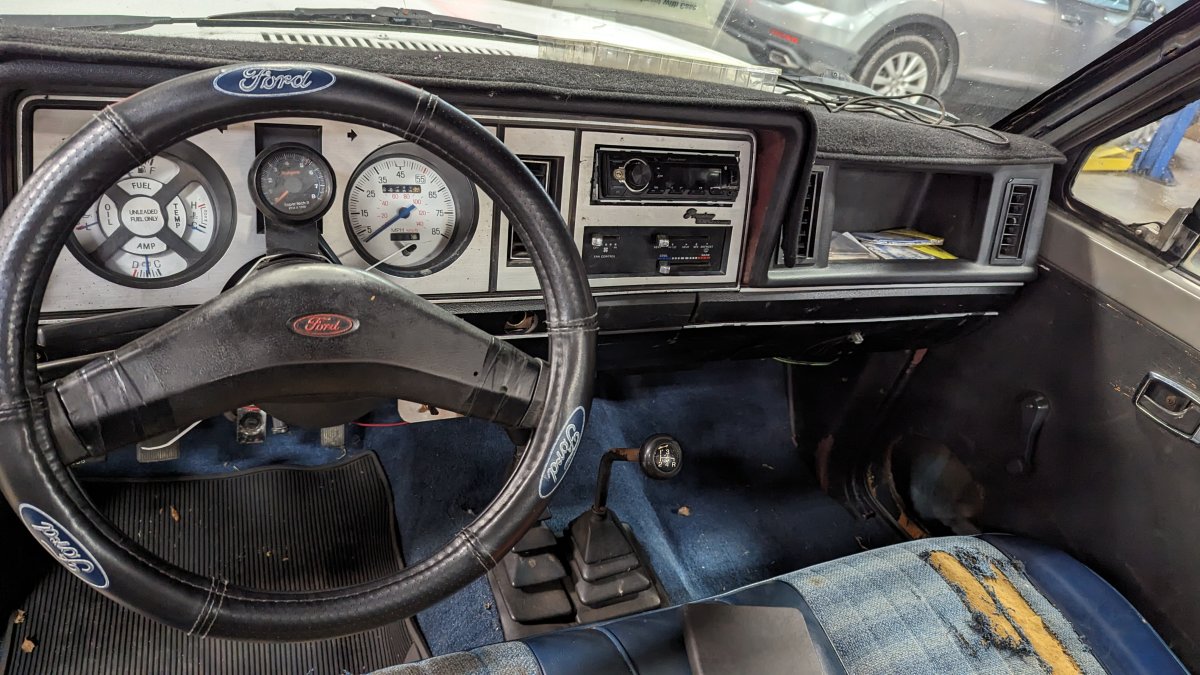

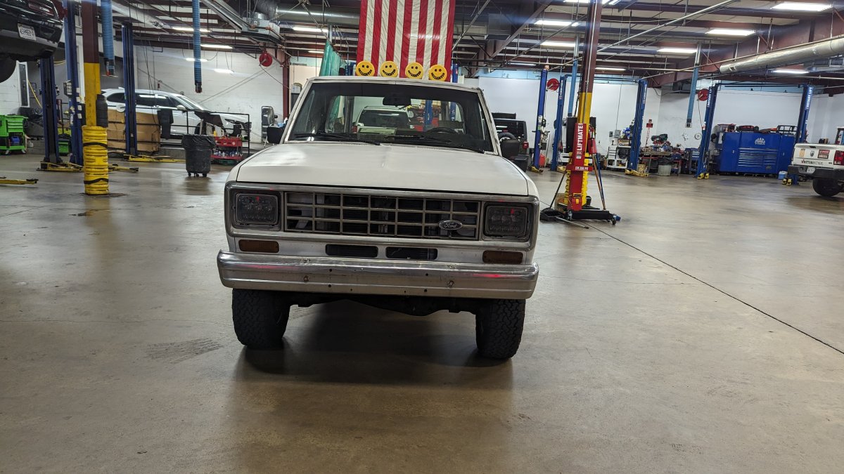

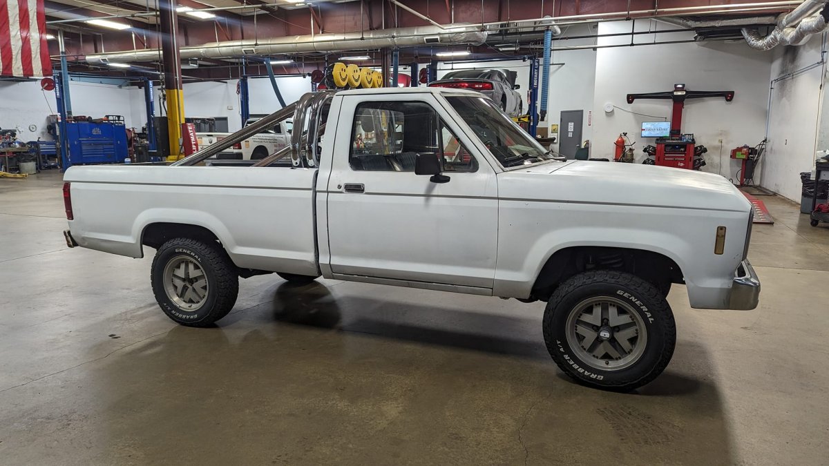

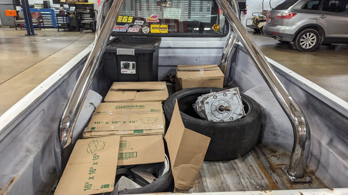

Thanks! The truck has "good bones" for a neat little project. I'll attach some more photos for y'all.
Truck came with a rebuilt TK-5 to swap from the TK-4 as well as another set of wheels and a box full of efi stuff and a power steering setup.
Window channel rust has been repaired and the frame is pretty solid. Optioned out to be a dual tank truck, but the rear tank has been removed and the rear filler door has been shaved. The switch in the dash still works though. So I'm going to attempt at adding the rear tank again using a fuel cell and a trapdoor in the bed floor.
I appreciate your insight on the engine mounts and hopefully I'll get them ordered soon so that I can finally drive this thing. Still working out why I don't have reverse lights, or interior lights, but I'll figure it out one of these weeks.

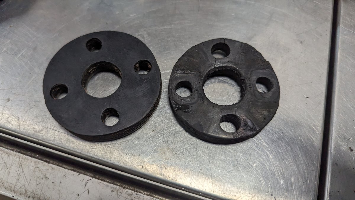

Replaced the rag joint this evening after work and it definitely feels much more solid.

Not 100% sure to be honest. Looking at my old rag joint, it doesn't look like any of the other ones I've seen in write-ups.
Mine was just a flat disc and didn't have any spacing.
My steering shaft also had a u-joint at the top and a rag joint at the bottom.
