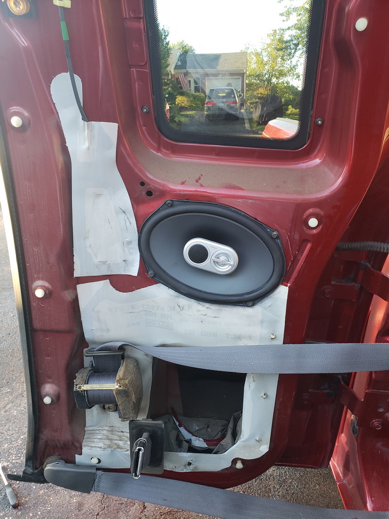

I came across a great deal on a set of Infinity primus 6x9's and went for it, hoping I could make them fit. Turns out they fit easily. A couple of minutes with a permanent marker to trace the outline and about ten minutes with a jigsaw was all it took.

:headbang: Those are some nice speakers, put the same ones in mine about 2yrs ago! :icon_thumby: paint marker and a angle grinder to the rescue....:D
Having an accurate 6*9 template to cut from would have made the job easier (and the cutout a bit cleaner). I got it approximately right on the first try and trimmed more here and there to finish the job.
Remembering to plug in the first speaker before putting the panel back on would have helped a bit as well. Still, $40 and maybe two hours of total investment was all worth it.
