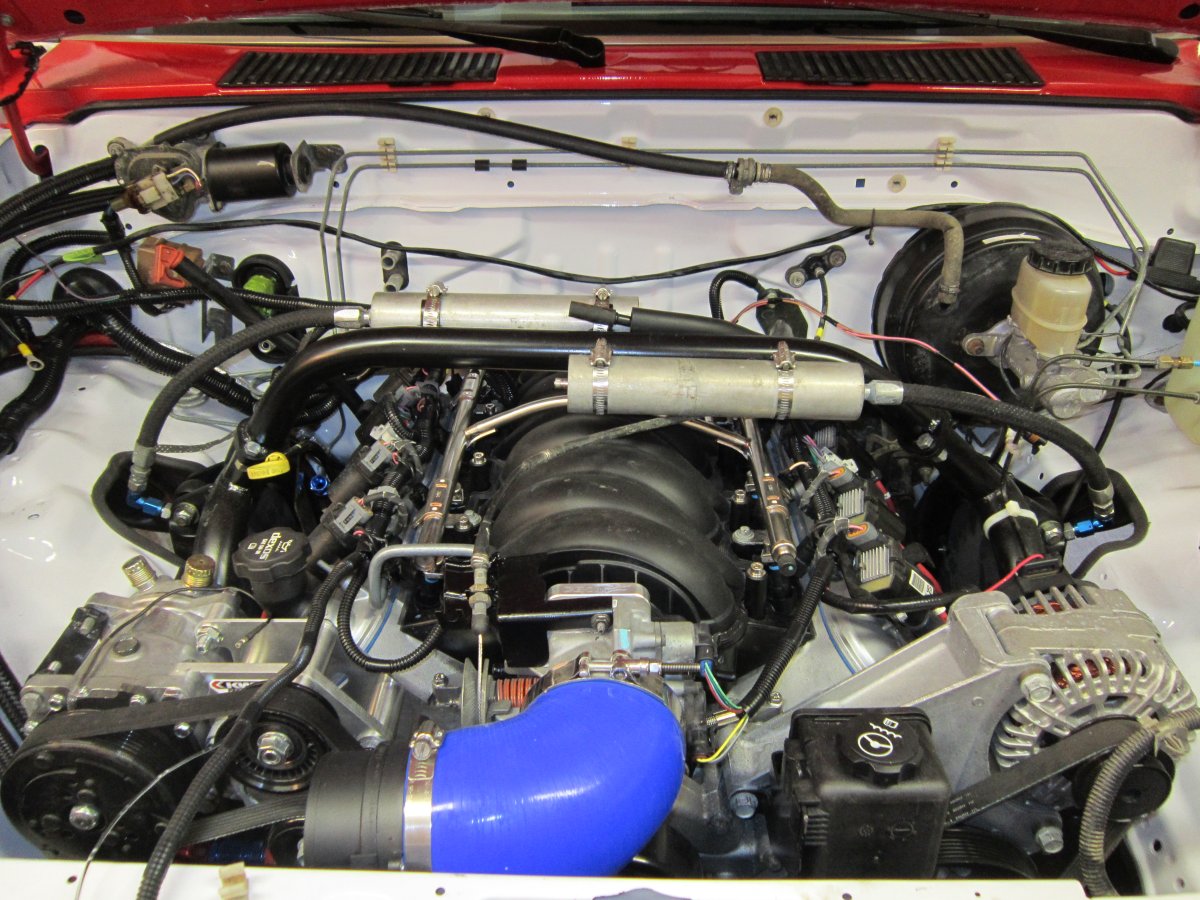

I'm using a Sandeen compressor and will be making AC lines to fit.
5.3L LM7
AC compressor is on the left side of the photo. I'm using a LS2 serpentine setup with KWIK Performance kit to move the compressor to the top.
