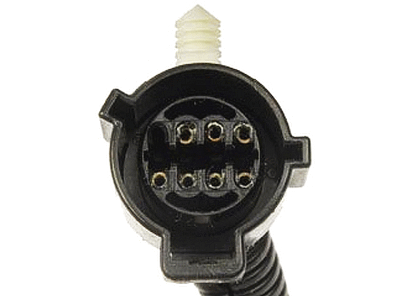

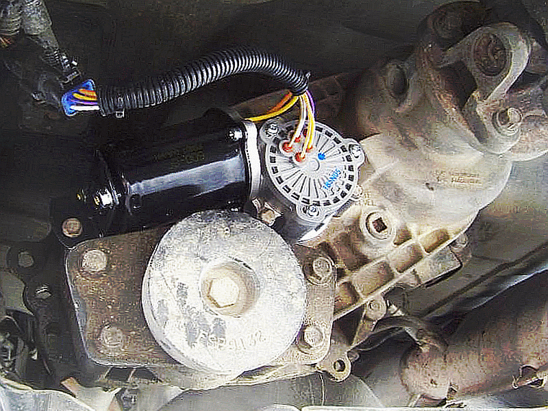

Sounds like a weak shift motor, if you see it rotate proper when removed from the TC stem. Bad brushes or bearings. Could take it apart & try to rebuild, or $75 bucks for a new one.
The Shift module use the 5 wires on the transfer case shift motor to "tell it" what position the transfer case motor is in....so what position the transfer case is in
There are no internal sensors in transfer case itself
When you turn on the key the 4x4 module powers up it checks the 5 wires to see what position transfer case shift motor is in, AND if it matches dash 4x4 switch
I assume the 2 4WD lights come on with key on and then go off, a Bulb Test, so bulbs are confirmed working
If you move the switch and transfer case shift motor doesn't move then 4WD lights should flash
If that's not happening then either the switch is not changing resistance/voltage or the 4x4 module is bad
You can test switch resistance between the 2 wires going to 4x4 module(colors seen in diagram below)
3,870 ohms for 2wd,
1,090 ohms for 4wd high
357 ohms for 4wd low
If resistance is not changing when switch is moved then switch is bad, or 1 of the wires is
The 4x4 module sends the switch 5volts
Module gets back approx.
4volts in 2wd
3volts in 4h
2volts in 4l
Yes, its a pull down circuit so resistance and voltage is opposite of what you would think
The 2001-2005 4x4 CM modules were failure prone, just a heads up, for "used"
The 2006 and up are NOT backwards compatible but they were only marginally better than previous 4x4CMs

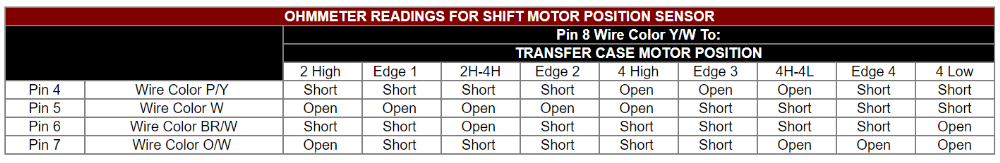

The 5 wires to shift motor can be tested as well, as the shift motor turns the contacts open and close(short), this "tells" the 4x4CM what position the shift motor/transfer case is in and when to stop moving/sending voltage

I really don't understand the chart for ohmeter readings. How are these readings taken using the multimeter? I think I'm in over my head as I have replaced each of the 3 components and I'm really not familiar with electricity or how to use the multimeter. Add to that I am kind of afraid of electricity and causing injury or damage.

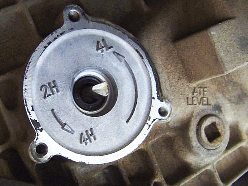

You can't take the readings on the chart unless you can make the motor move. You will have to get a battery charger of some sort and move it manually on the bench to get those readings.
Good luck. You already know my feelings on this system. Part of the problems with mine were corroded connections over on the driver's side inner fender. Even fixing that only got it working for a year or so. I don't know about the later trucks,, but the early ones I have had are really bad about throwing road grime/water/salt up onto all those wire connectors laying on the driver's side fender, causing problems. I took a piece of rubber and cut it and attached it to hang over the steering box and that stopped it.
In this instance an OHM meter is used to tell if a contact is CLOSED(short) or OPEN
Set OHM meter to 200 OHMs or any OHM setting
Touch the two metal tips on the probes together
Should see 0 ohms in the display, that means there is a SHORT in the circuit, which is just the two probes because they are touching, but if one probe was on one wire and the other probe on another wire and you saw 0 ohms then those 2 wires are Connected(a closed contact)
Separate the probes, what do you see?... thats what you should see when a circuit is OPEN, no connection between the probes, or wires you are testing
