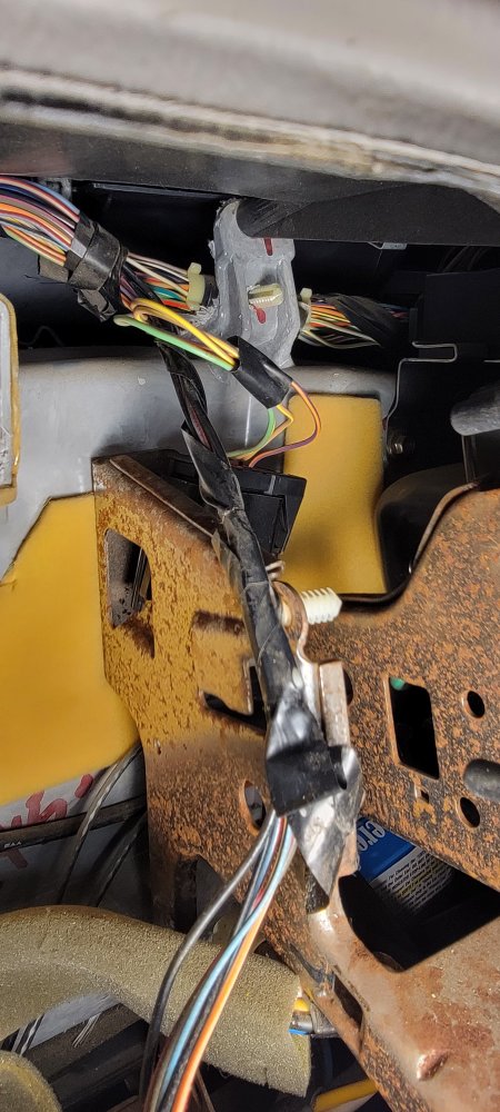

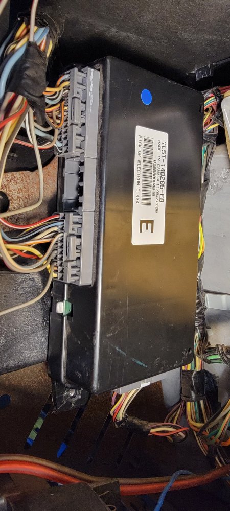

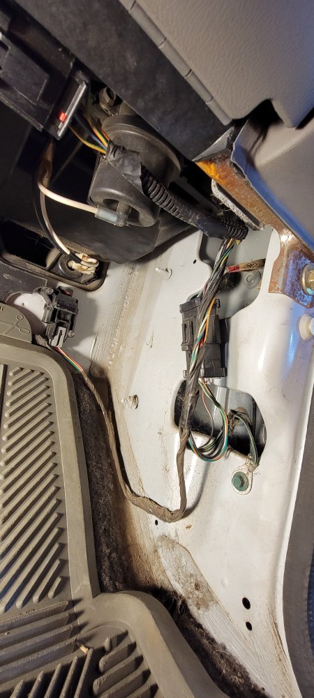

I have the kick panel on passenger side removed and do not find the mentioned 4x4CM. I have attached some pictures for reference to what I am looking at.

GEM is for sure the 4WD control
It's possible there is a GEM issue

So I think you are down to GEM issue

I took truck to a family members who has a scanner tool. We were able to see the switch mode go into 4low, but nothing changed in GEM to tell motor to shift. When cycling through 4 high, GEM responded and showed each contact close and open as motor rotated.
