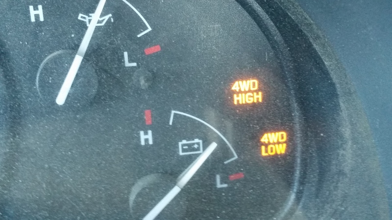

Update !......I bought a used Transfer Case Module from a junk yard, ($85 vs $200 new), and so far, I get dash lights every time I crank up !
