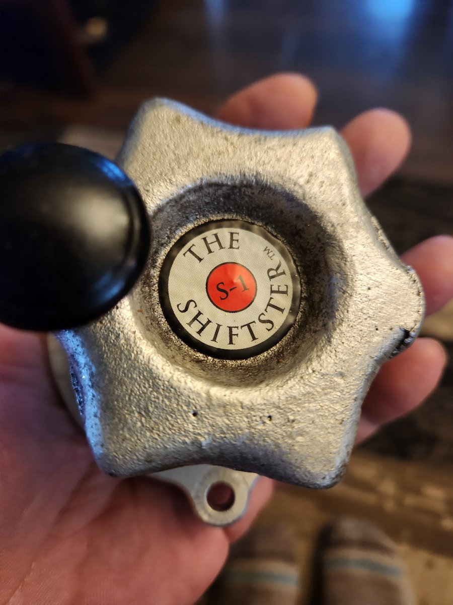

They did make a "Shiftster" at one time... rare to find anymore. It would replace the motor and required you to crawl under and turn the knob to shift it.
I have one i travel with incase of motor failure during an outing.
