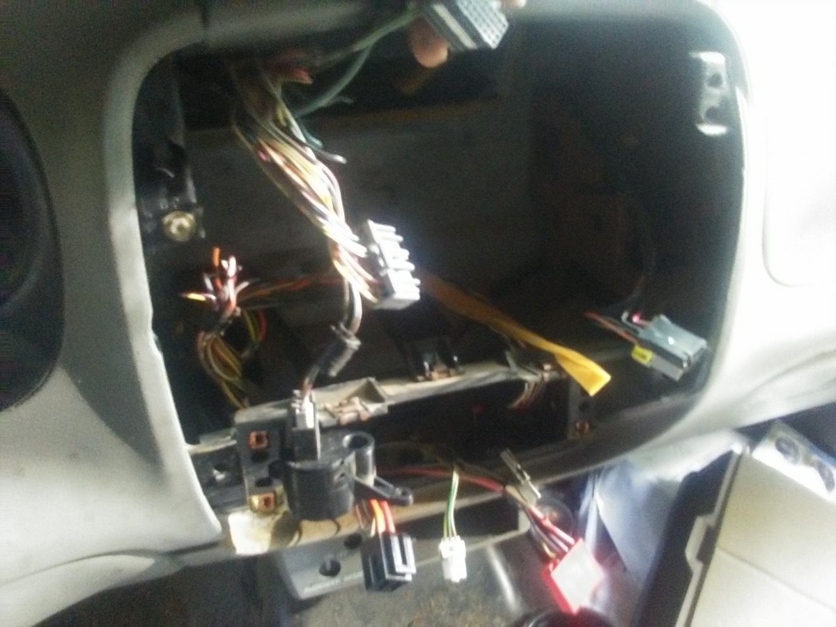

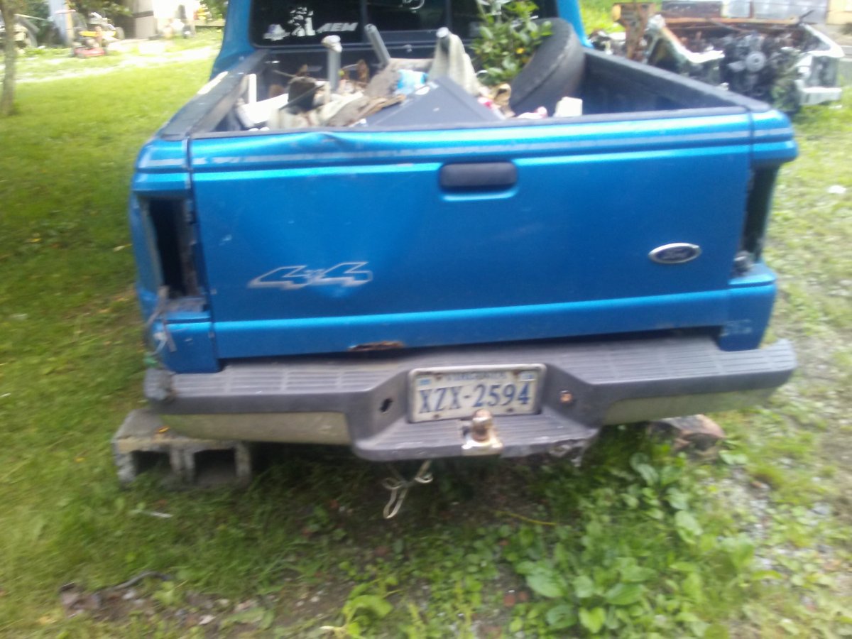

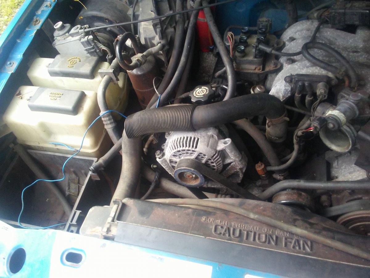

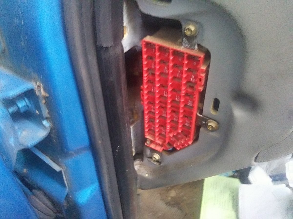

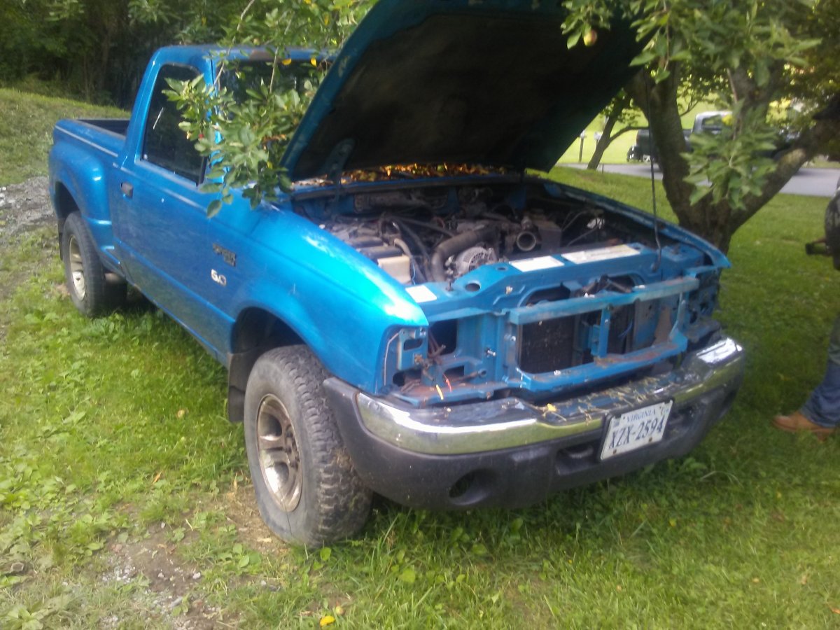

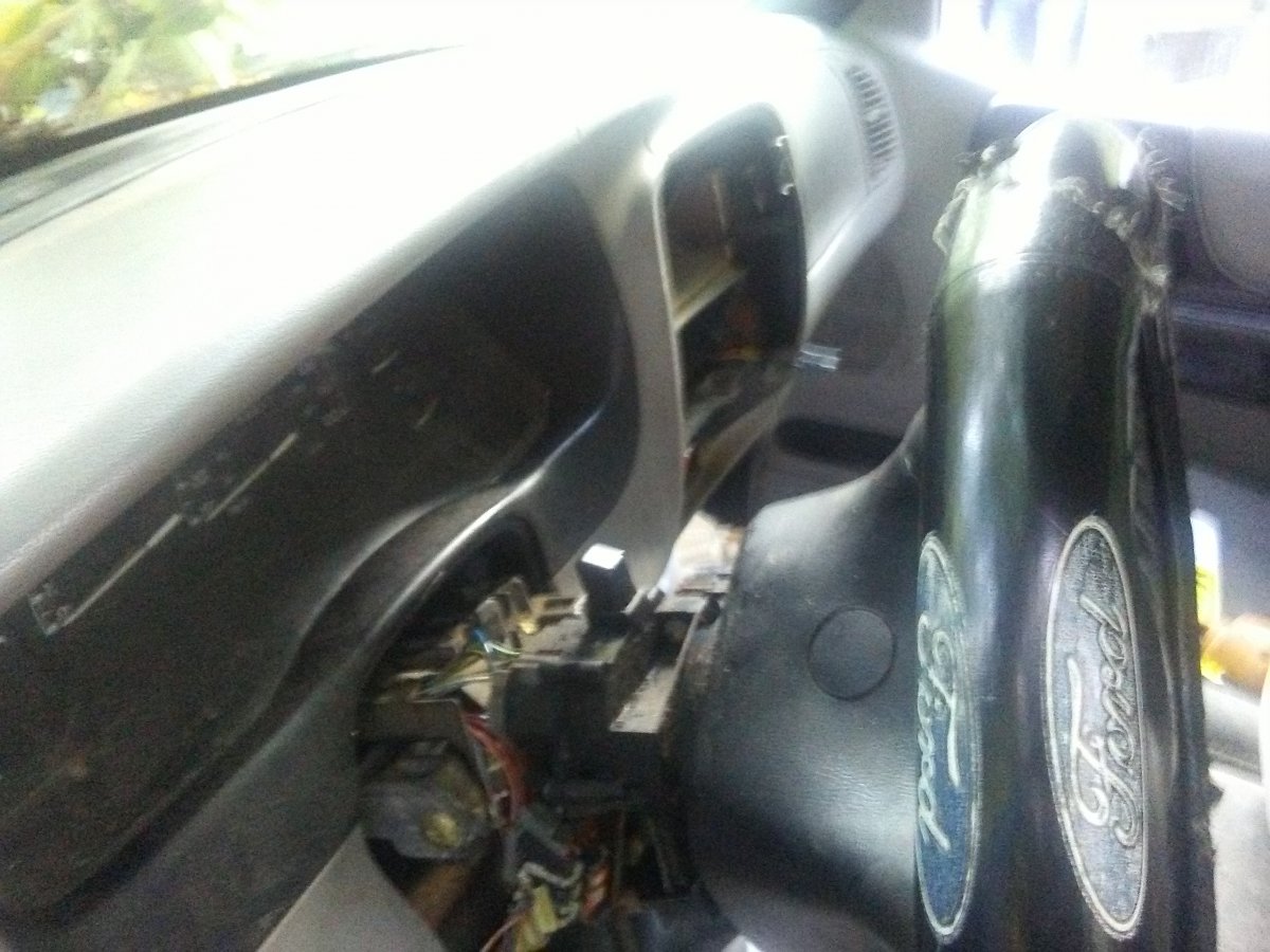

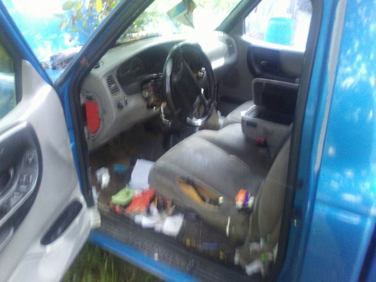

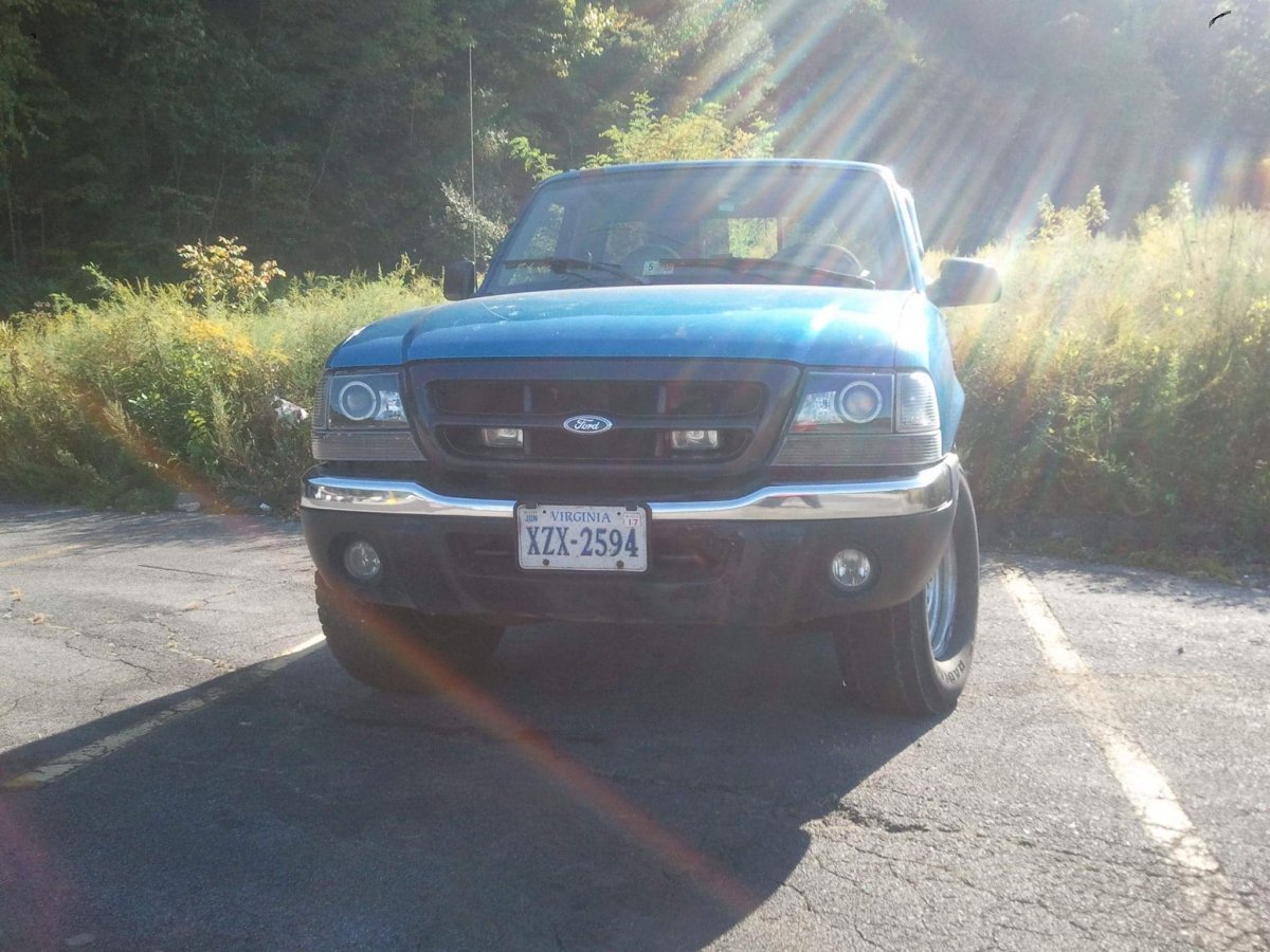

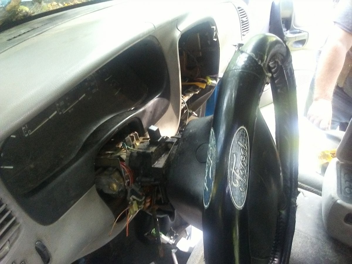

I have a 2000 Ranger XLT 3.0 5-Speed 4x4. I was letting my brother borrow the truck and he left it parked at his house she he was out of town for work for a couple months and it was stolen and had a bunch of parts stripped and wires cut and so on. I know it will take a lot to get everything back how it was so I was thinking about just making a little hot rod out of it instead. I know starting with a 2wd would be the best course of action but this truck holds a lot of sentimental value since we have owned it since almost new. My dad bought it with 12K miles on it in 2001 and I learned to drive in this truck and it was passed down to me when he couldn't drive a manual any longer. It has over 400K on it now and I've driven literally all over the country.
I am wondering what all I would need from a 2wd truck to convert this one over suspension wise or if there are any major differences that would make it impossible to convert it over. The plan is to switch it to 2wd and drop in a carbed 5.0 and 5 Speed just to get it driving again then eventually go turbo with it.
Attached are pics before and after it was stolen. Thrives suck.

Do I have a frame for you - unfortunately, I am on other side of country and north of 49. (My '98 2wd went shiny side down and frame is about all I haven't scavenged to date). What scotts90ranger says about frames and all suspension bits being different from front of box forward between 4wd and 2wd is correct.
My solution to make your truck a 2wd would be - get a pair of Ranger Edge knuckles, and then remove all the 4wd parts from the front of the transfer case forward. You can worry about removing the transfer case when you do the V-8 swap. 2wd Bronco IIs had an empty transfer case (BW1359), so you could pretend it was stock.
On other hand, 4x4 regular cabs are less common, so I wouldn't mind seeing this truck restored to former glory.
The 2 relatively easy ones:
The wiring for box is same whether 2wd or 4wd, you just need to find a '98-00 Ranger and pull the wires for the flareside (the connector is at back of box). Hell, if I can find mine, I'll send it to you for shipping. You will of course need new tail lights..​
The underhood wiring is same whether regular cab or super cab, you just need to find the right year ('98-00) and options (4WABS being the less common one) the wiring is tedious to remove but with a little patience, not difficult to pull.​
(I probably have all the front end pieces, but you might have to pay for a couple of those - I have a '99 Ranger and they are "spares" for that).​
The bit more complicated one - swapping out a dash. In this case you would be looking for a 4x4 SuperCab with 4WABS. (The dash swap isn't hard, it only about dozen bolts and equal number of connectors, but it is big and bulky.)
Note: You need to fix most of those whether you go 5.0 Explorer EFI drivetrain, 5.0 Carb'ed or LS.
