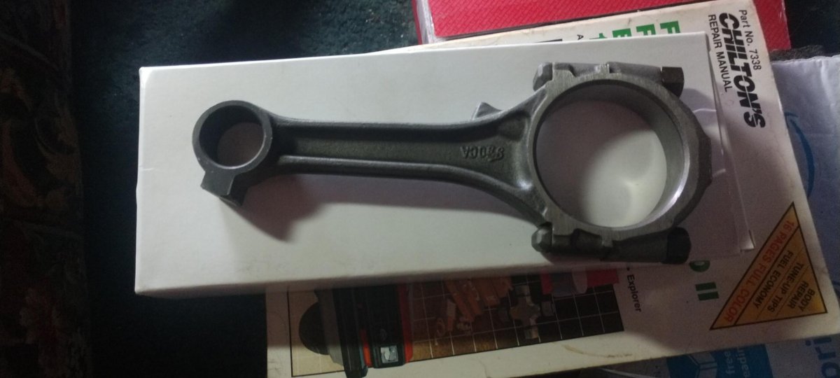

There us nothing wrong with using stock piston rods but get ARP connecting rod bolts. If you want to get some more power back from the enginerrs at Ford, there are 3 types used in this engine; the set marked "F boca" (known as the RIBBED style) are the lightest and offer a rotational wright load reduction to the engine = increase in efficeintcy.
Two other considerations with the connecting rods are:
1) peening, having stock rods peened will increase their strength and is much cheaper than buying forged.
2) annealing, having stock rods anealed will also increase their strength and is alsi much cheaper than buying forged
Both processed permit the use of stock rids with increased reliability bar the cost of forged rods.
