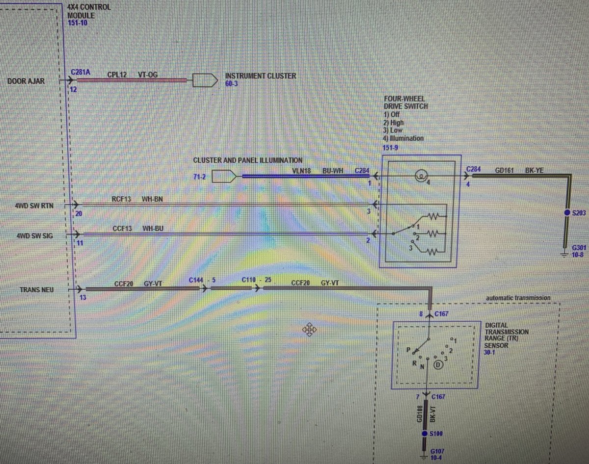

Ok so, i have a 2009 ranger, 4.0 4x4. I did a manual swap, transmission from a 07 b4000, i can get into 4 high but not 4 low. Any solutions?
64638
Pin # 13 on the 4x4 control module needs to see ground, when your auto is in neutral, to shift into low... you no longer have an auto, I suspect that is your issue.
Problem is most likely Neutral switch/sensor, can't shift into 4low unless system "sees" that you are in Neutral, and...............speedo is at 0mph, and foot is on the brake pedal usually
Neutral in a Manual trans is clutch pedal down
So did you wire up the Clutch switch?
On the automatic's DTR sensor was a Grey/purple stripe wire, it runs to pin 13 on the 4x4CM(control module)
This wire needs to be Grounded to indicate Neutral to the 4x4CM
Unfortunately Ford must have bought alot of the grey/purple wire, lol, because there are 3 of them on the DTR sensor
Pin 8 on the DTR has the grey/purple wire you want, ground it
If you wired in the clutch switch then you could use it for 4Low
Clutch switch has 3 separate switches inside
All are OPEN when pedal is UP
All are CLOSED when pedal is down
One switch is used for activating starter motor, another is used for REV limiter, 3rd could be for 4WD system
Connect grey/purple wire and a ground wire to that one switches contacts, clutch pedal down = Neutral

Update: i grounded pin 13 and no results. It will hit 4 high. But no 4 low

Since you have grounded pin 13, unhook either battery cable and touch it to the other battery cable, that will drain capacitors and all modules memories, then reconnect battery and try 4WD system again

I don't see anything in the system that would prevent 4low if pin 13 is grounded and foot is on brake
The "door ajar" light must be working and OFF, I assume it is
I don't like coincidences but.......................maybe 4WD switch is not working for 4LOW
The switch has 3 resistors
The 4x4CM sends the switch 5volts
4x4CM gets back
4volts from 2WD setting
3volts for 4high setting
2volts for 4low setting
So pretty simple setup
