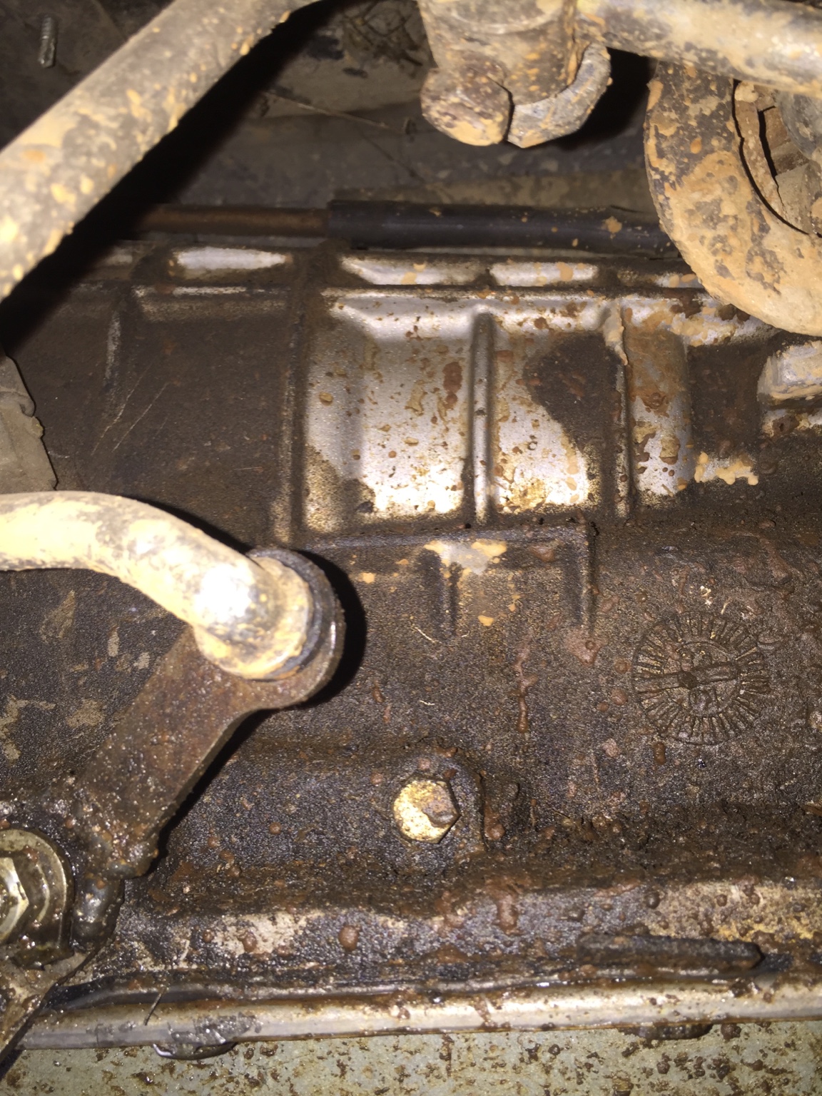

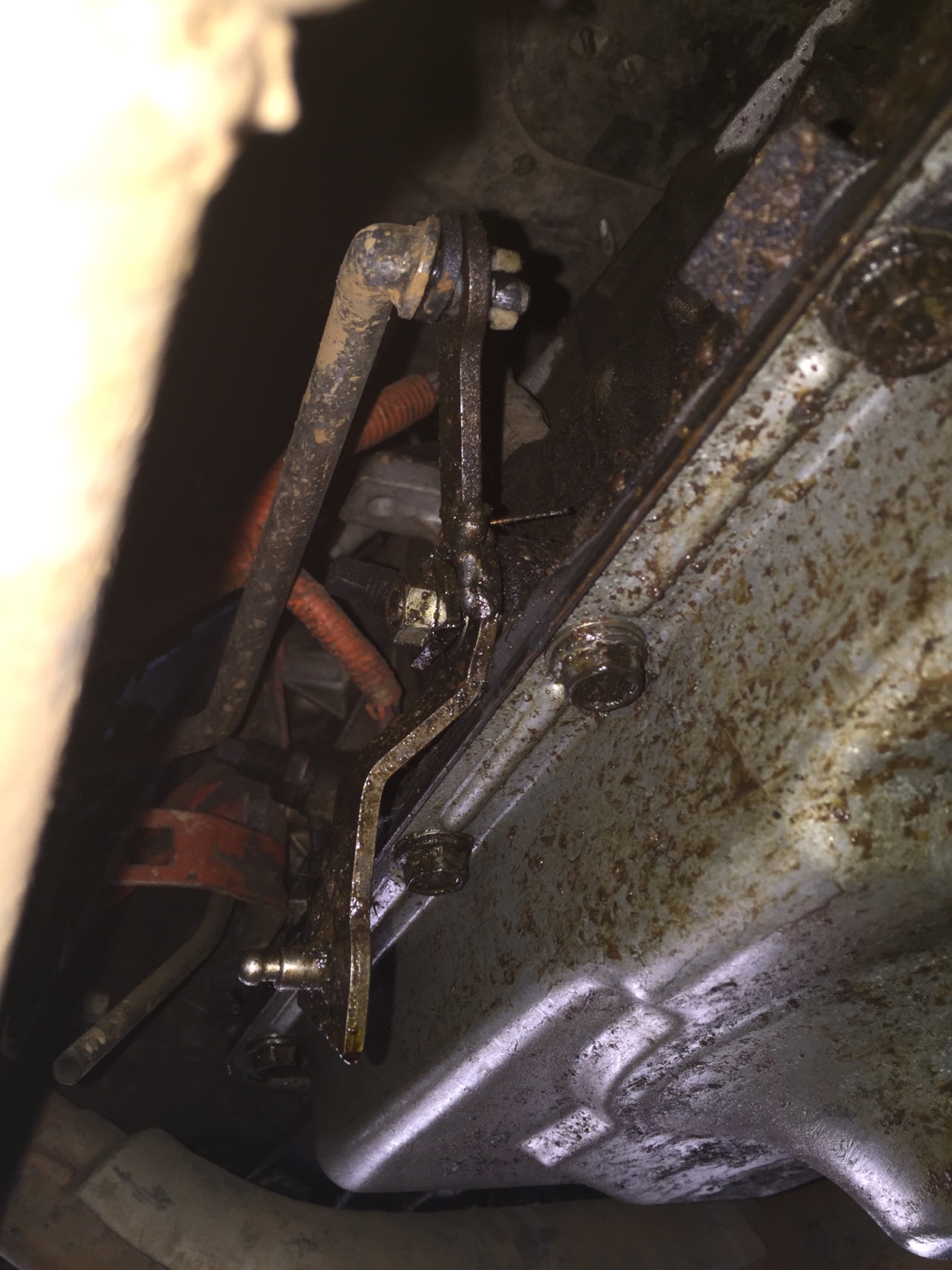

What I did was cut the shift linkage arm of the a4ld from the 2.9, welded it to the top of the a4ld shift linkage on the 4.0. Kept the cable linkage because I would like to make an aftermarket cable floor shifter work at one point but for now this has worked great. Also kept the interior look original to the 88 b2.
Noting the photos in above post-what i did is drop the tranny pan, pull the lever/ shaft assy and clocked the lever at the 12 o'clock position instead of the six o clock. Then made a custom linkage from all-thread and heim ends that allow for more misalignment when the truck flexes. Never had it pop out of gear even flexed out. The throttle valve arm will also have to be modded a little. I also love my floor shifter and like someone above said many options here but just make sure the gear detents match your shift gate detents. Like bobby said above- this is where your arm ratios come into play.
