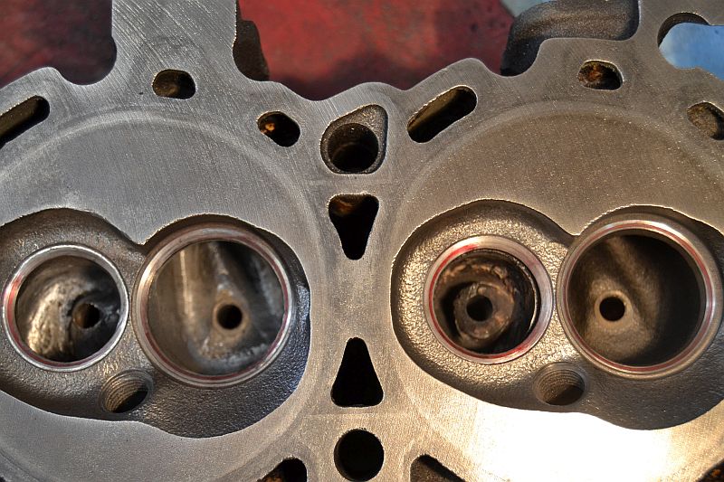

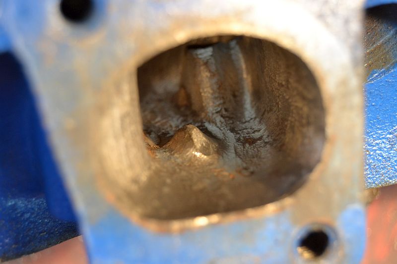

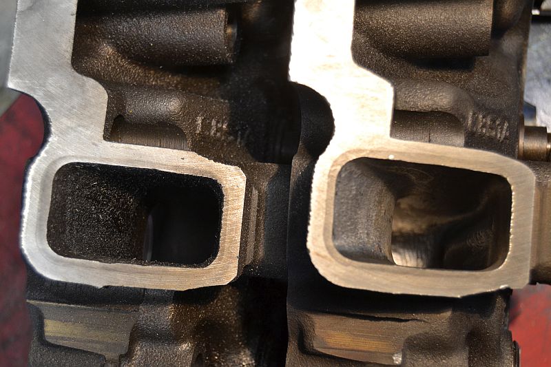

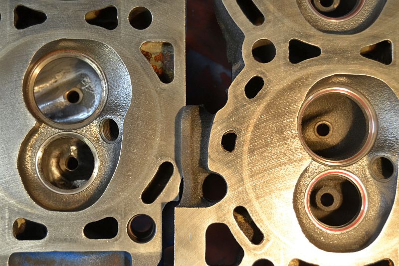

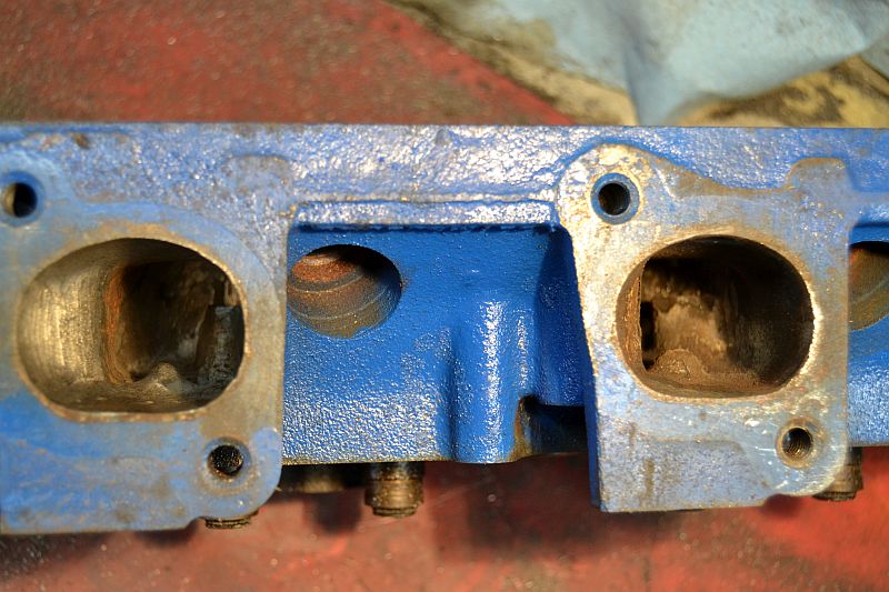

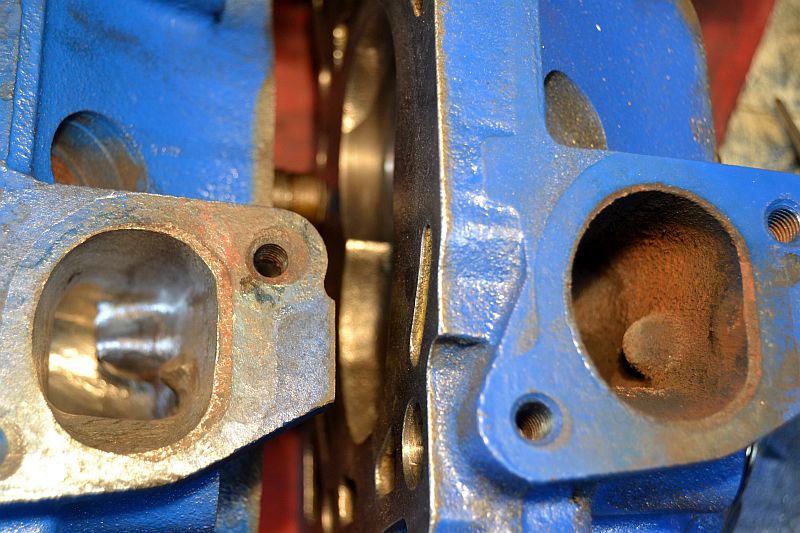

As requested, here's some pics from the porting I did today. One head is done and the other will be done soon.
